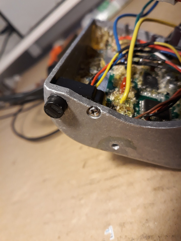

I think this sensor that is screwed on the motor controller but is in visual line with the crank, is a PAS sensor. I verified it has signal 2 wires output (digital signal) that reacts when I pass a magnet in front of them and seems is a kind of quadrature signal and this way should be possible to detect if pedals are rotating forwards or backwards.
Question: I didn't saw any magnets on my crank, can you guys say if the crank has magnets??

Guys, this is how the torque sensor of your motor works and you can see how fast it reacts:
[youtube]1xiMbCerRKw[/youtube]
NOTE: This video is dedicated to stancecoke/hochsitzcola for his hard work on documenting the ebike torque sensors and helping on our OpenSource firmware for Ebike motor controllers.
On this video, our firmware running on TSDZ2 motor controller, reads the torque sensor ADC value and send by UART to the PC and were it is shown in the graph.
This was the very first time I was able to understand how the original firmware controls the hardware to read the torque sensor.

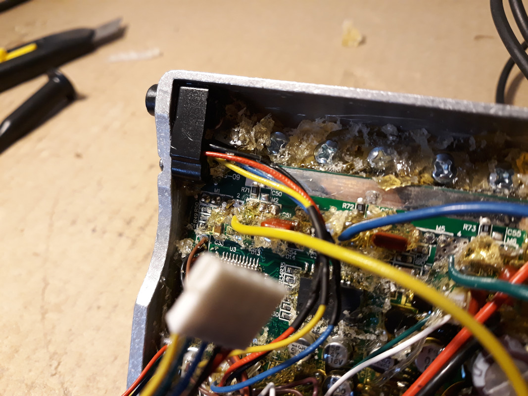

Guys, this is your motor running with our OpenSource firmware (at max of 3866 RPM with the 36V from lab power supply)! I was using a throttle on that test.
So, since the other last video, seems that what is missing right now is "connecting" the torque sensor signal to the motor "throttle" signal, right?? Not yet, first I need to be able to read motor current and limit it to the max recommended value to this controller or the mosfets will burn :)
What I did learn that may be important for you:
- the controller can run with a battery pack from 7S (24V) up to 14S (52V)
- seems that all controller versions have the same hardware but for instance, brakes and throttle wires are missing. Don't know about the original firmware but our firmware should support all options (so, every controller version will work with or without brakes and throttle)
[youtube]O9shbfQ9hHk[/youtube]

It is the same controller, you can even see the metal part attached (the controller is not only an electronic board).
I found the limitation of measured current on this controller: 18 amps.
STM8 pin PB5/AIN5 measures the analog signal for the battery current and for each 1 amp, the signal increases 0.275 volts. The max current measured is: 5V / 0.275V = 18.18 amps. Assuming the signal can be linear and I did my measurements correct, maybe the measured current can't be more than 18 amps.
And yes, modding the shunt should change the relation 1A/0.275...
Anyway, this measured battery current on the shunt will let the firmware protect the controller as also control the motor torque, so we can play on the firmware like implementing a torque linear ramp to always control increasing rate of torque.
