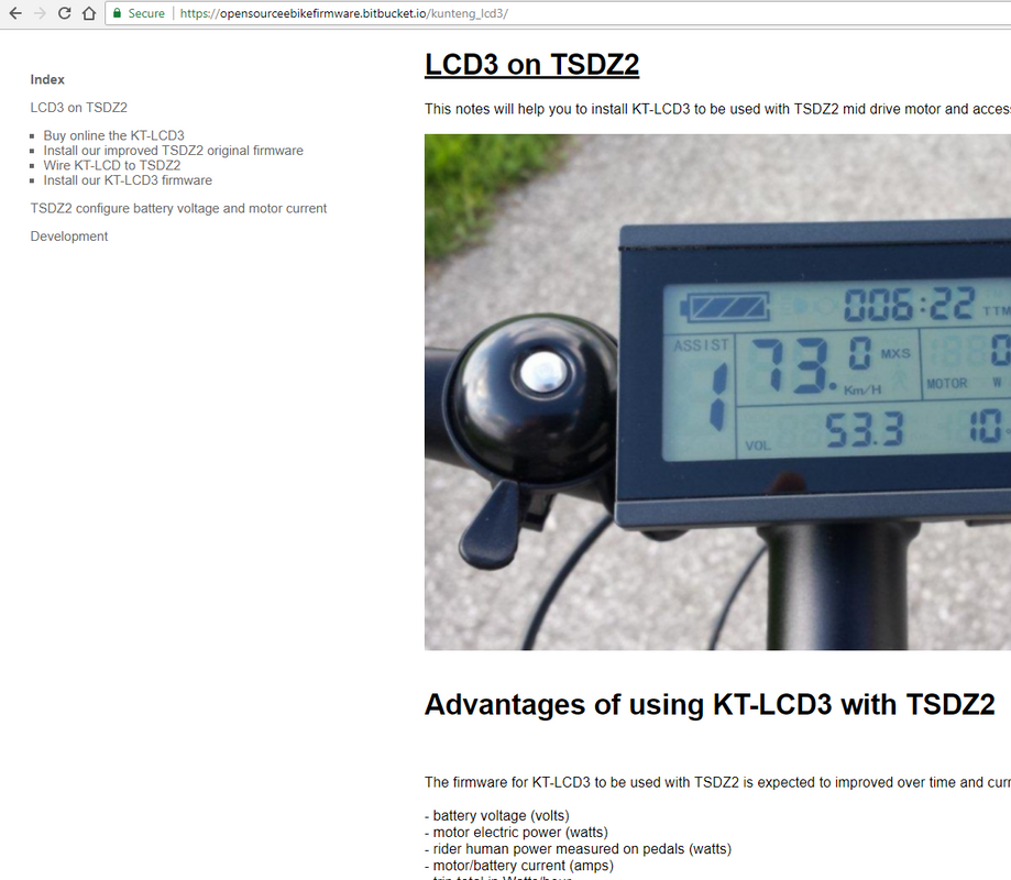

Finally I wrote the notes to install KT-LCD3 to be used with TSDZ2 mid drive motor and access unique advanced features.
See also the way to configure on EEPROM the battery voltage 24V/36V/48V/52V and motor/battery max current!!
https://opensourceebikefirmware.bitbucket.io/kunteng_lcd3/
Well, for the part about the eeprom values, that was just a guess of me that I told you.
At least for the voltages, I had some new insights that say something else:
https://endless-sphere.com/forums/viewtopic.php?f=28&t=94351&start=50#p1384193

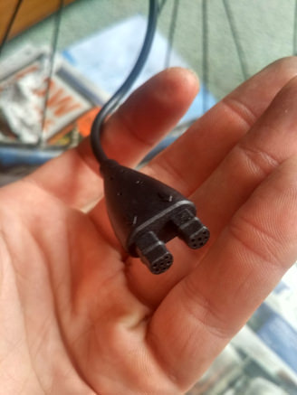

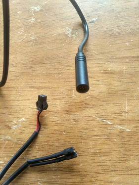

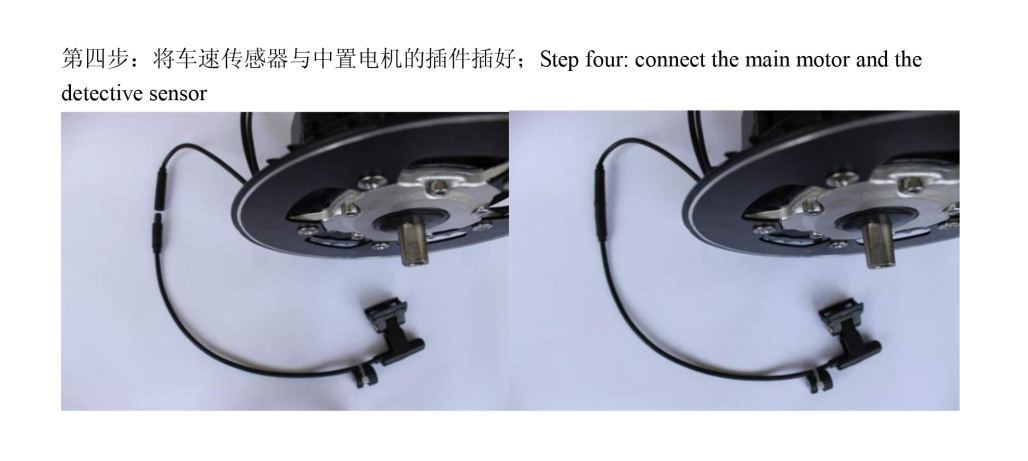

What the devil is going on here:
Why does my speedo cable have 2 connectors??
The manual only shows a single connection:
And what's this mysterious 1-into-2 cable for? I'm guessing it goes into the other connector from the speedo but where does it go to? I can't see anywhere that would take these type of connectors?
