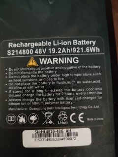

I don't think that setting does anything. I've tried it in both ends of the scale and felt no difference.Hi everyone, I'm experiencing power cuts on my tsdz8 coupled with a 19.2ah G70 battery. Sometimes I can't restart the battery until I plug in the charger, so quite bad. The battery seller told me that the motor requires too much power and that triggers the battery protection. Is it safe to reduce the nominal power from the vlcd display setting to see if that helps? The default is 16A, I'm trying with 14A.
Any help will be useful, thank you

It's a 48v battery, its description said it comes with LG cells inside so I was expecting good qualityWhat battery do you have (it is not a 36V battery by any chance)? Did you check voltage?
I'm quite light, me+bike would be about 85 kg. It doesn't happen when I start, it always happens when a slope comes while riding and I push a bit harder to gain momentum for it. And always happens when the battery is below 75% or so.I don't think that setting does anything. I've tried it in both ends of the scale and felt no difference.
What's the combined weight of bike and yourself? Do you always start in a low gear when moving off? Starting in a high gear can cause the motor to pull a lot of power.
It's strange, it showed 53.9V right after charging, then I checked a few more times and it kept showing different values... First went down to 53.2, then went up to 54.4, now it settled at 51...What is battery's voltage when fully charged?
If you're measuring that with a multimeter on the battery output, that's almost certainly a battery problem. Most common is mismatched or failing cells, where the highest voltage ones as it first hits full charge (before you let it sit for hours, days, or weeks to balance) are the worst cells with the lowest capacity / highest resistance. Appears to charge to full because those cells are overcharged by some amount before HVC kicks in, then they're drained down by the balancers (or internal leakage) and then the overal pack voltage can be a lot lower (this usually takes up to a few hours).It's strange, it showed 53.9V right after charging, then I checked a few more times and it kept showing different values... First went down to 53.2, then went up to 54.4, now it settled at 51...
Thank you very much for the reply. I actually have two bikes with the same motor/battery combo and both are having the same issue. So I suppose it's a common issue for this battery. Actually the seller told me that the g80 model is better and he's discontuning the g70 when I was ordering but I assumed he's just trying to sell the more expensive one and went for g70. So I feel he knows there are issues with the it. I'll keep trying to return/exhange them for g80, he's refusing for now.If you're measuring that with a multimeter on the battery output, that's almost certainly a battery problem. Most common is mismatched or failing cells, where the highest voltage ones as it first hits full charge (before you let it sit for hours, days, or weeks to balance) are the worst cells with the lowest capacity / highest resistance. Appears to charge to full because those cells are overcharged by some amount before HVC kicks in, then they're drained down by the balancers (or internal leakage) and then the overal pack voltage can be a lot lower (this usually takes up to a few hours).
The going up in voltage doesn't make sense, however, assuming you'd disconnected the charger. If you hadn't, then it makese sense if the BMS turned off the connection to the battery, and you were then just reading the charger output voltage (which should be about that much).
If there *are* mismatched / failing cells, then they'll also drop down in voltage under load, and make the whole pack voltage drop. If it's low enough it will cause the BMS to actually turn system power off. If not, it can just cause the controller LVC to engage and turn off the assist (or with some controllers it will just lessen the assist as voltage drops far enough so you still get some assist without killing the battery).
