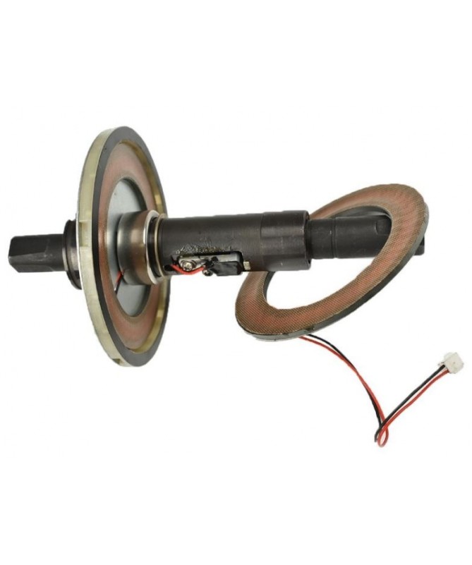

I received a new torque sensor from PswPower.
But before mounting it, I will test a throttle (I ordered one) to validate that the power problem is indeed due to the torque sensor.

So I mounted the new sensor. (i have a good experience in mechanical) The most touchy part is replacing the big washer receiving the signal : You have to manage to pass the two very thin little wires in a narrow channel where 4 wires already pass (those of the PAS).
Now, the engine works great. Nothing to see! Where I was struggling to get to 12-13 km/h by pedaling hard, I now go to more than 20 with ease.
I measured the gap between the magnet and the small Hall effect sensor: 0.9mm on the old one, 0.5mm on the new one. Maybe that was the problem.
Everything would be perfect if PswPower had sent me the right gasket (the previous one had broken into pieces). I'm going to ask him for the right one.

For Zambam : i've received the complete sensor, that :

This morning I did my usual bike commute route. Nothing to do with the previous version of the sensor! I have a big climb (several sections at 18%) on the route, where I was struggling at 10 km/h, I go without difficulty to 16/17 km/h.
This engine is really nice now, quite comparable to a mainstream engine like Bosch, Shimano in terms of sensation, but more powerful.
