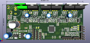

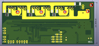

Hello everyone,
I have completed my design and now need to fine-tune some bottom layers, such as masking layers.
Please let me know if you have any suggestions or see any areas for improvement.
For Hall sensor detection, I have used the BAT30KFILM [convert +5v to 3.3v signal ] diode, the same one used in the B-G431B-ESC1 Discovery Kit.
Regarding the transistor logic: it is designed to operate at 3.3V and should work correctly at this level.
Best and regards,
BldcLover
