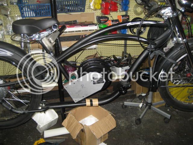

Ok, so I have been looking over this thread, and love all the great designs, and came up with my own that I would like critiqued:
(Sorry for the awkward angle, but it might make more sense if you look here too at my E-Bronco Build as this is going on a stretched cruiser as Mid-Drive: https://endless-sphere.com/forums/viewtopic.php?f=28&t=44997&start=25)
The idea is to have a 1/4" steel bracket coming from the clamps on the seat post, made in sort of a BMX style "drop out" but then take four 2 - 3" lengths of 1/2" square rod of mild steel and have them bolted to the plate horizontally, and on the ends have vertical pinch bolts.
I intentionally made the space wide so that I could use this to tension the chain and then clamp it down as this way I would always have a good solid attachment between "torque clamp" and Hub Motor Axle, allowing for the slight size variations of axle thickness.
Please critique!
Thanks in advance - 8)

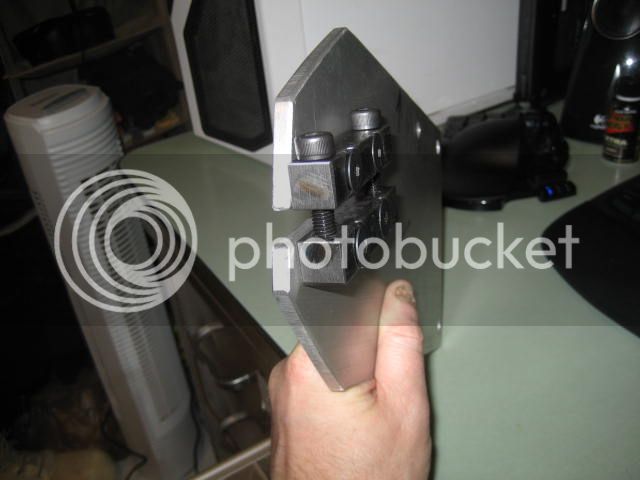

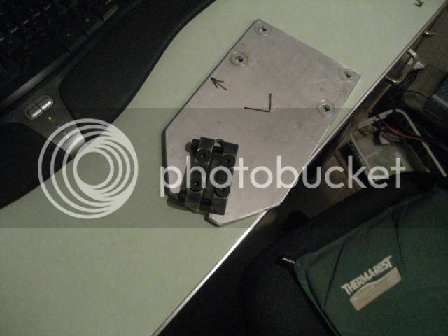

Made a scaled Drawing of the "torque clamp"
*** edit ***
I just realized that the last two horizontal screws on the right side need to be countersunk (make room for the axle nut) so I am changing all the horizontal screws to countersunk.
Shouldn't the pinch bolts be as close to the axle as possible?
Shouldn't the torque handling bolts be as far away as possible?

As this is a mid-drive, chain is how the power gets to the rear wheel.
I agree that you want the pinch bolts close to theaxle as possible, however, the compromise is both for the ability to slide the axle for tension, and also to make room for the wiring to exit on the non-drive side.
If I can get away with the pinch bolts both being on the inside, I will, but I fear that will not allow for enough space to both tension the chain or allow both that AND room for the exiting wires on the CroMotor on the non-drive side.

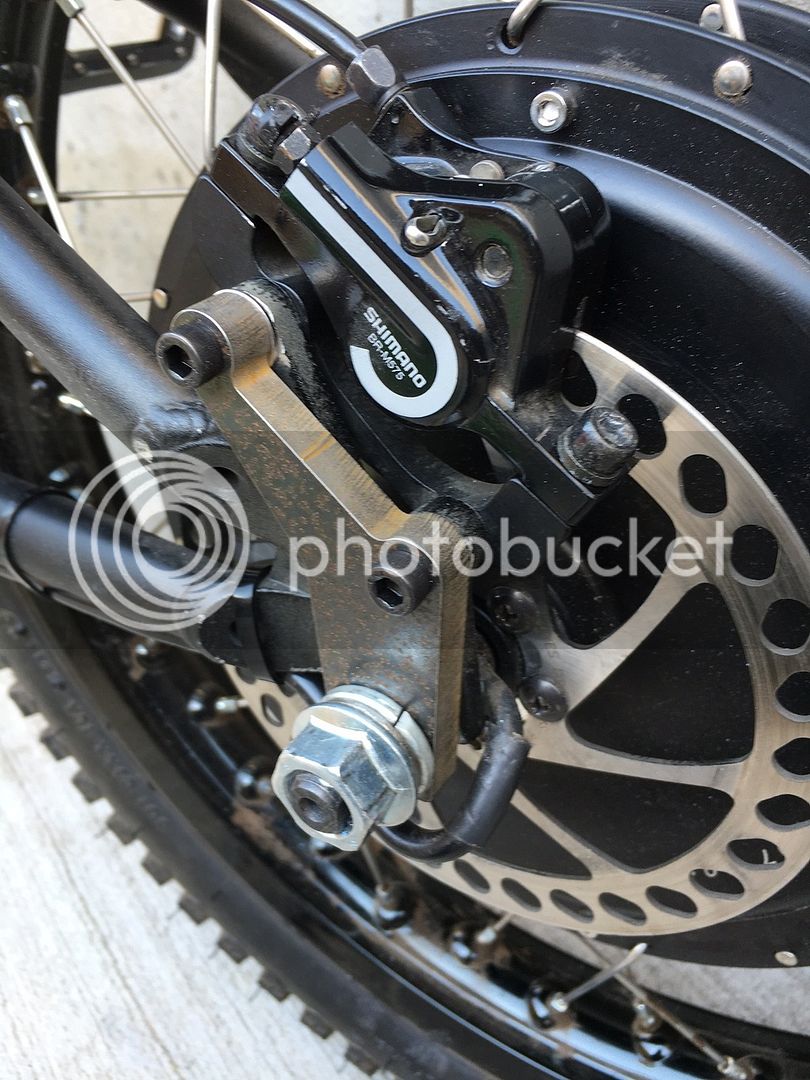

The bike is a Marin Pine Mountain. The dropouts seemed pretty beefy amongst first glance after buying it via craigslist. I ran 48v and ~1400W and 72v ~2000 for a few weeks without any problems. Attempting to true my rim I noticed that my axle was starting to slip so I modified a crystalyte torque arm that I was using on my old bike. The axel in the vertical dropout alone has a significant amount of play. And the torque arm can even be rotated a few degrees on the axle. The vertical dropout allowed me utilize half of the crystalyte torque arm on one side and the other half (and a small wrench) on the other side. I haven't noticed any slip since the addition of the torque arms. It's been holding up pretty well for the first 100 or so miles.
Do you think this crystalyte torque arm pre loaded one way any the and a drop forged 10mm wrench preloaded the other way will suffice for the "rocking" motion that will occur if I enable regen braking? Keep in mind I'll be running 2000+ Watts and using regen at 30+mph.

I like the idea of the fully floating pinch plate for sure. A variation on the idea I used with two angle irons.
Much better IMO, than the designs that flex a slot closed. If you think about it, they pinch more on the open end, and may not pinch at all on the closed end. Having at least one side float allows you to tighten down hard on both sides of the axle flat.
Disadvantages, it's only as strong as the bolts. I'd say, go ahead and beef up the steel. make it 3/4 thick, so bigger, stronger bolts can be used.
Zero reason to have a nut once it's pinched hard, so I would not worry too much about that. And one piece can just be welded to the plate. Bolt if you like, but it can be welded. only one side needs to float. The floating side needs no bolt to the plate, but if you like, you can use a bolt there too.

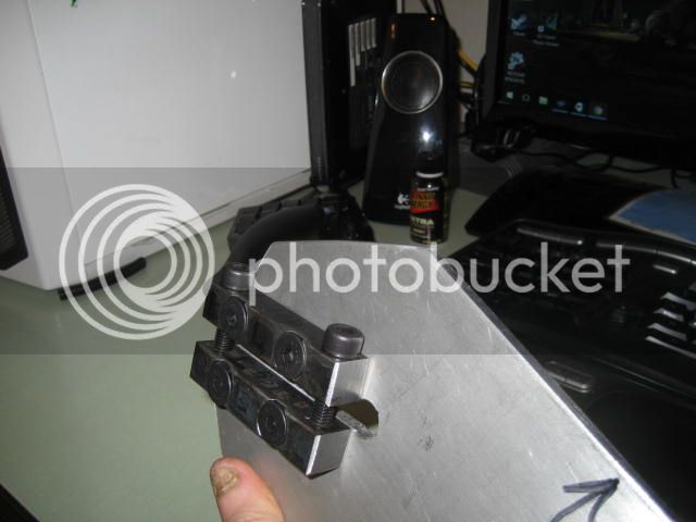

Here are some pics from the finished product, I have yet to put it under power, but I think you're right Dogman, 3/$' might be even better, as I am making the countersinks the same diameter as the pinch bars, so I will probably use 3/4" mild steel instead of 5/8 next go around, but I think this will suffice for testing at least.
