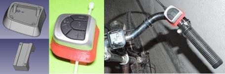

I have now extended the base conically and selected a height of 10mm.
https://github.com/stancecoke/ebike_wireless_remote/blob/master/3d_design/VLCD5_LowerPart.FCStd
If we need less space on the bottom we can reduce width and hight again. This is a very first draft, we can still round the edges, make pockets for the button cell and the nRF52840 board, etc.
The spacer for the handle bar will be an extra part, that's easier for printing.
regards
stancecoke

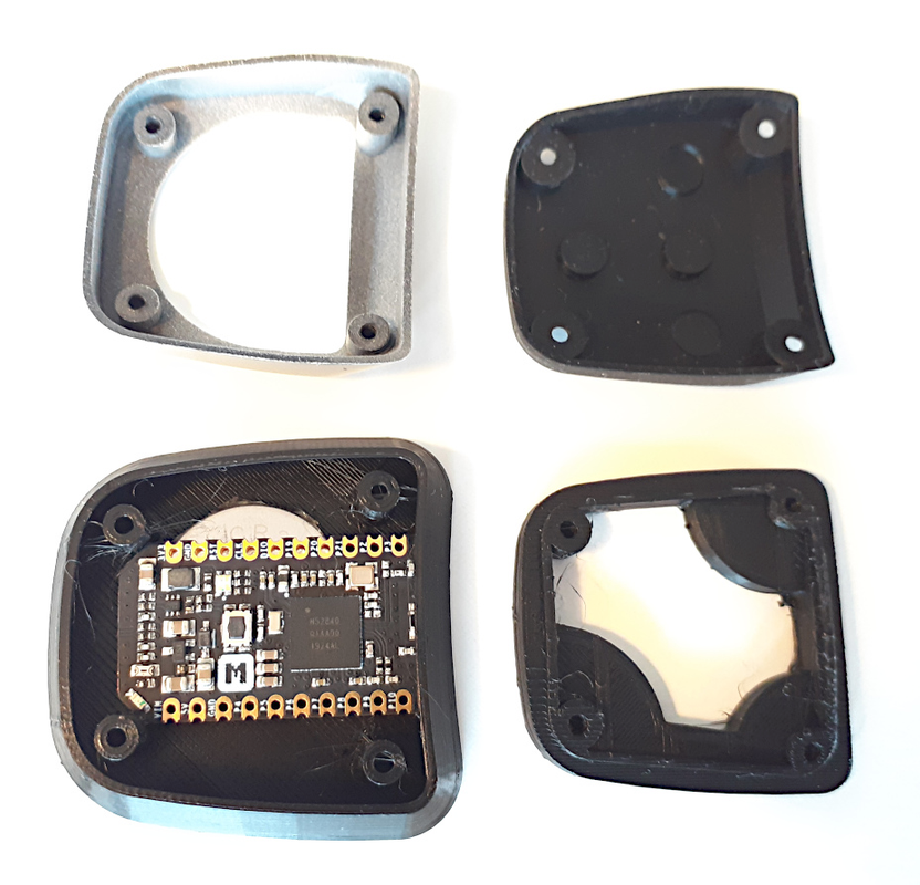

I printed the new part, see the battery and board on the picture.
Some notes:
- would be nice if the holes could be larger in a way we could use the original screws - seems possible to me
- the height can be lower 1.5mm
- the conic shape is important in one side to be able to put the board inside but
not needed on the other sides, so reduce the size of the remote
- the remote must be water prof. There will be a bootloader and then firmware can be updated by Bluetooth, so, user will only need to open like once a year or two years.
This part should have a fit with the top part, se we can put some silicone glue that will make water prof.

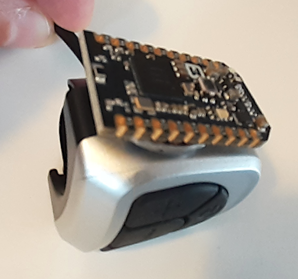

More ideas
Why not design everything in only one block, like this that I tried - I guess than the top thin shell would need to be design and printed so we would not be limited by the original screws position - this block only would mean for sure water prof:
See the example of the 860C remote, which I think is the best I used. As there are always the brake handler, gears handler, etc, this remote can be on top of various handles and the buttons then be near the place of our hand fist -- this is really important!!
With current design this is hard as we have a big Z axis...
photo url

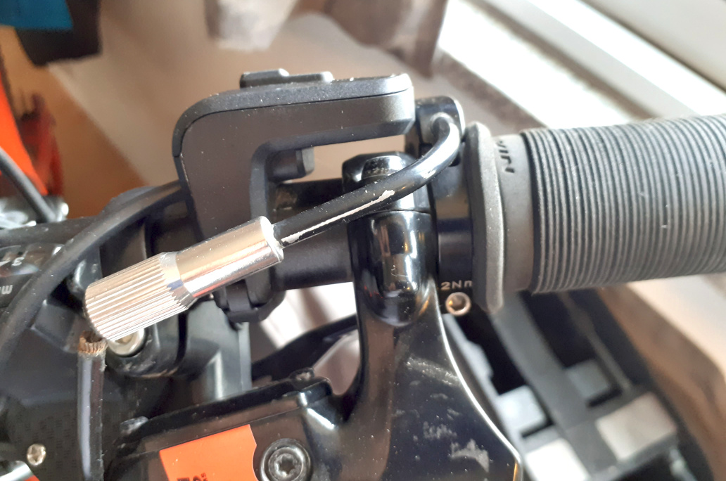

And here the gears shifter, has some space between it and the handle bar... the new VLCD5 remote with the thin metal part should fit well, using the thin space available:
Another idea could be this, put the board and battery in one side... maybe we can explore this in future:

I've added a flange to the upper edge, so we have a sufficient surface for glueing. It is a bit difficult to print because it is undercut. Two holes for the brake wires are added also.
The spacer for the handlebar is also ready. To fix it you can use a cable tie or a screwed clamp.
https://github.com/stancecoke/ebike_wireless_remote/tree/master/3d_design
This must be good enough for the moment. You can modify the design easily, as you can move the edges in the sketches by drag and drop.
regards
stancecoke
p.s. I've mounted it on the wrong side of the handlebar, obviously :oops:

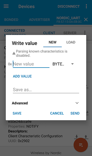

I am start to look at the examples of ANT+ and BLE, it seems very modular, easy to add to our current project.
I will start to add that option / characteristic for change the ANT device ID, as I will have to learn anyway.
I also need to understand how the Android app is structured in terms of this same characteristics as I need to have the configurations on the mobile app working.
