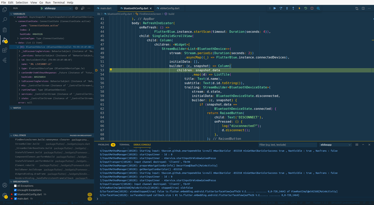

Well, so now I should take care of the JSON?? Can you help on this? Please find my latest firmware here: https://github.com/OpenSource-EBike-firmware/TSDZ2_wireless/tree/bluetooth
I will be looking how I can run and debug your app...

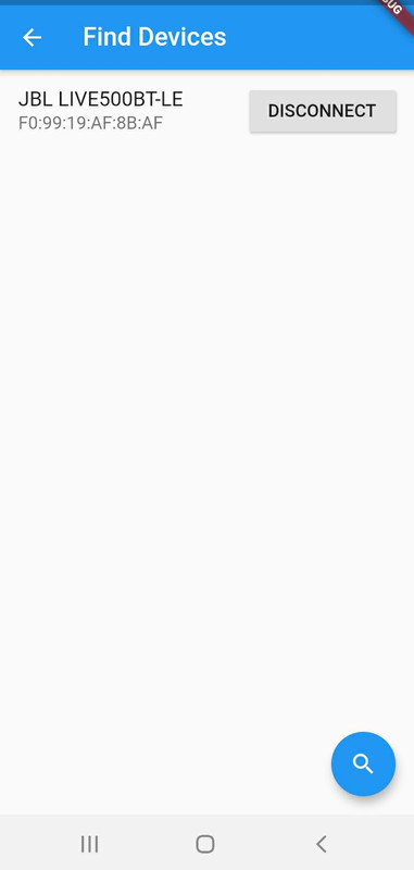

@raw,
I was able to open your project on code studio and run and debug on my phone.
It only lists one device one device from a few that should be shown... And I can't disconnected it, it always connect to that one and doesn't show the others. Please solve this!
See that the most priority thing is to be able to see and change the configurations. Then, the next priority is a main page that shows variables like the wheel speed and so on, this will also help me to debug all the system.
I am happy I can run and debug the Flutter code just like on Android studio. But there are disadvantages, that I don't understand nothing of Flutter and on the other side I can easily tailor TSDZ2-ESP32 Android Java code to work for my immediate needs. So, my plan for now is to keep working on the Android Java because is the only I can do and I will wait for you to develop the Flutter version - if you will be faster, then I think I will be able to switch faster to Flutter... TSDZ2-ESP32 Java is already done, that is also a big advantage. I think it all depends on your help, how fast you can develop the app.
Here a screenshot showing the run and debug of Flutter code, somewhere I think the implementation is not good because I only see that Bluetooth device although I have a few more around:
Yes, flutter has some learning curve. when coming from c/c++ android (java) is much more straight forward, while flutter belongs more to the latest reactive web development efforts (react, vuejs, angular).
flutter is also pretty new so there are not many people familiar with it. but if starting some app from scratch i would always go the flutter route because it is faster and easier to get something going (especially no messing with different android SDK versions and their compatibility problems). getting iOS support for free is only the cherry on the top :)
casainho said:
@raw,
Oh, you are fast! Ok i will look into it this evening.
if you are really curious, you can test the flutter_blue sample app which is basically like the nrfConnect app (scans devices, lists services): https://github.com/pauldemarco/flutter_blue/tree/master/example
If it does not discover and disconnect there correctly while it is working as it should in nrfConnect, then there may be something wrong with the (not so mature) flutter_blue library.
So I decided to try, and I did a few times and I always got the same as on your app. This time, when clicking on OPEN I get the throw as seen on the next image.
So now what?
