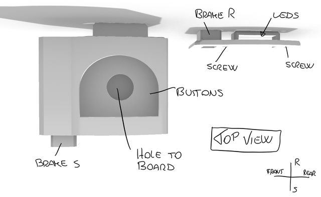

First sketch of the remote done, 3D printer friendly! :)
https://youtu.be/k8F_IKy4_Qg
I have to print it to verify the dimensions and tolerances, after that i will focus on impermeability and design.
What do you think about this first sketch?
I must say I can not visualize, maybe only If I 3d print it, I will understand.
So, at least we know that we want to reuse the VLCD5 buttons, add the wireless board, the battery and space to wire the cables for the brake sensors. I hope you saw our previous messages where we tried to design something that would reuse only the VLCD5 board and buttons pad. But we decided to go with simple box for the wireless board only because it is simple as also will let us see the RGB LED of the board.
The only thing I think is important, maybe not possible? on your design, is to be like the VLCD5 keypad that you can install or remove from the handle bars without removing the other installed parts like the brake levers, etc, so, it should be easy and fast to install or remove from the handle bar.

I've tried to elaborate a design with removable keypad, but i think it will be too difficult to realize, most of 3d printers have too high tolerances to allow this, furthermore i've no idea on how to link a plug and play keypad.
In my design i reuse vlcd5 keypad (top housing), both leds are visible (bottom housing), there is a lateral housing for 2032 case, the 3 housings are linked by holes for wiring.
Based on what i've read on this topic i've designed also 2 brake connector housings, but not for shift sensor.

Ok, now I see... It seems a bit complex but good that you got it.
I think we did agree to use only the RGB LED, if that helps on your design, you can hide it.
I think allmost no one use a shift sensor - this is out of this project.
I think is ambitious to design the full remote and not the box only, but should be better as will be clean on the handlebar!!
And do not worry to be perfect, we can improve later with the feedback of real users... Is so cheap to design and 3D print again :)
One last wish is for later redesign using FreeCAD and, I guess will be easier after you did that hard work of the initial design.
I wish to play a bit with the 3D model, to increase at least the height to the handle bar, as I have some brake levers that I wish to put the remote partially on top of them...

Yes, it is a bit complex, but it's optimized for 3d printing, i designed that in order to be printable also by a very cheap 3d printer.
Both leds are visible, i can hide one or both of them... it's irrelevant for the design, you can freely choose!
Im going to print and test it!!
I never used FreeCad, i use Rhino 6, but i will try to export the project.

I am thinking to start with translucid/white silicone to fill the LED but I remember rananna mention a specific component for this.
I would prefer only the hole for RGB LED.
The board can be cut a bit, on the USB connecter. If you see it helps the design, do it.

Wow, this looks very interesting.
Unfortunately, I have a hard time visualizing the complete assembly in 3d in my head, but I really like the concept.
What would be the dimensions of the final assembly? I am especially interested in the height off the bar.
Looking forward to seeing your prototype!

I've already cut the usb connector as described in previous posts.
Ok, im going to cover Led2.
I prefer transparent silicone to make it waterproof!

I've posted a link to a youtube video where i show the 3d design, sorry for the quality of the video.
The dimensions are the smallest possible, asap i will post the precise dimensions and other images
Can you please share the STL and STEP files so I can 3D print, even if far from perfect, since I am building my remote right now.
You can always do a pull request with that files to the remote repository, will be ok to share here the files and will then be on the project source files.
