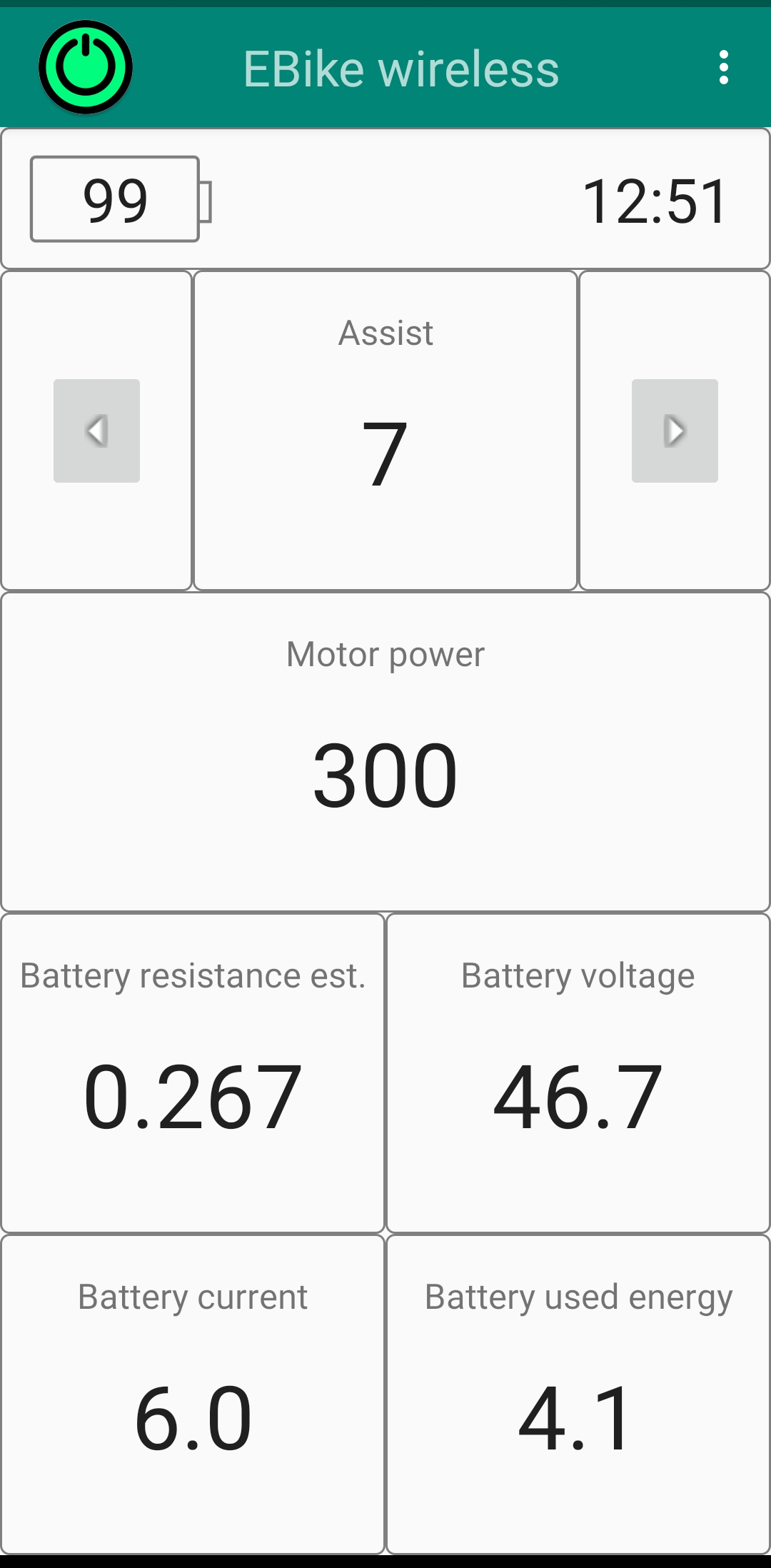

Changelog:
- Battery SOC now resets every time the battery voltage is over the configured value (previous was resetting only at wireless board power on)
- corrected Battery Voltage field
- added Motor Power field
- added Battery Resistance Estimated field
- corrected all the decimals on the various fields
- hided Street Mode from configurations as currently there is no way to active it
As you can see, my battery has an estimated internal resistance of about 270 milliohms:

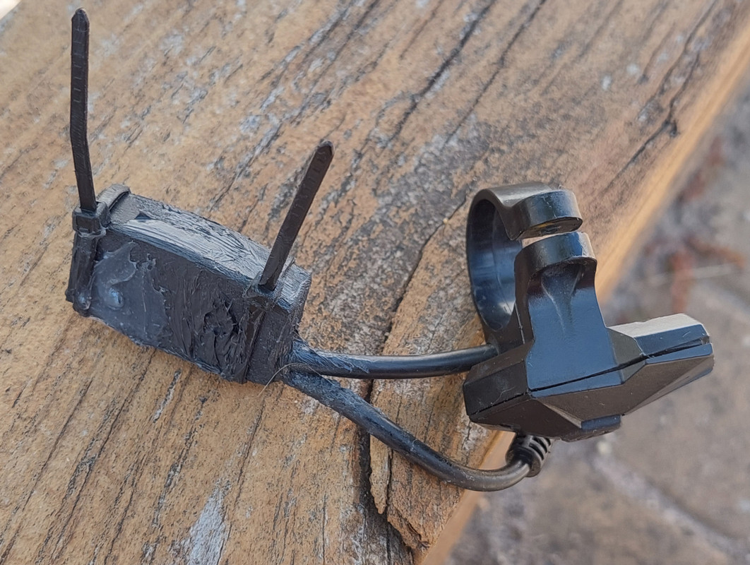

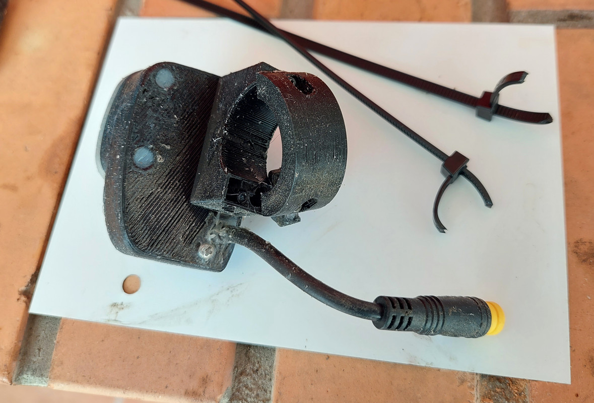

And my wireless remote broke... because I did 3D print almost hollow as can be seen:
And I really hate the VLC5 buttons that I will stop to use them!! As I am preparing our mini cargo bike, that will probably be driven more by my wife, I need buttons that work very well as the user feedback is very limited to the LED. I am thinking that the most operations I really use are:

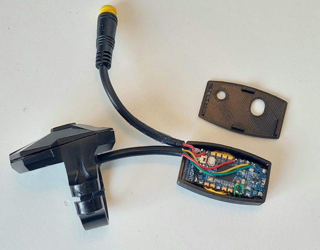

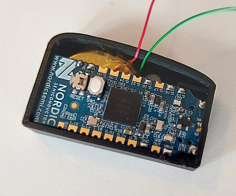

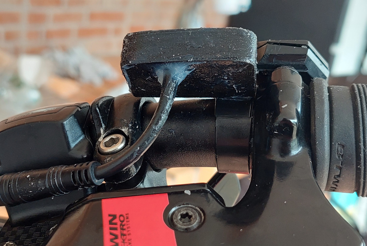

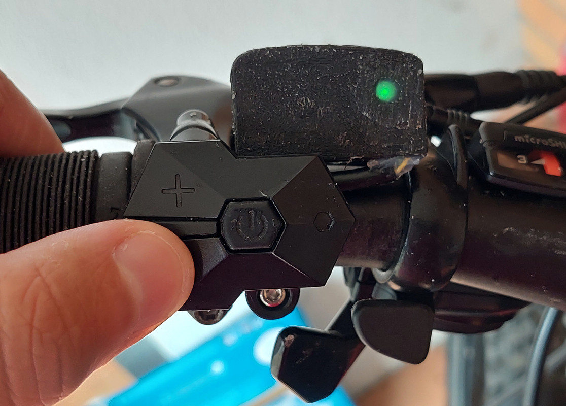

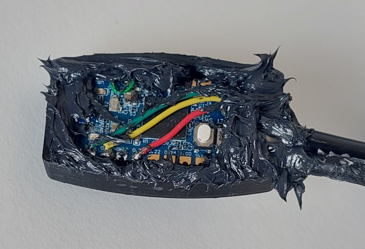

I decided to make the smaller possible box to old the wireless board and battery, for my wireless remote. I have with me a 860C and 850C remote, while 860C remote is more robust and provides 4 buttons, it is also very big and seems more a remote from a motor cycle and not from a small bicycle (after being using 860C, I found it to be to much big on my handle bar).
My small box, with all the wiring: brake sensor 2 wires + 4 wires of the 850C remote. The 2 small green wires are connected to the CR2032 battery that is placed under the wireless board:
Then I decided to use black silicone to seal the box and make it water prof:
There is a big hole for the button that has the black silicone and the small hole for the RGB LED, has translucent silicone so I will be able to see the LED light - on next 24h the silicone should be hard and finally I will cut the excess of silicone. The zip ties are there only to hold in place the box cover for the next 24h. On the next design maybe I will add 4 little screws on the corners as using the zip ties is strange to me, the screws are probably better + the silicone:
I will keep testing this idea and later I will document on the site this build, which is much easier than the previous one.
What black silicone sealant are you using? There are so many options, and it seems like using the wrong one risks water seeping in after some time.
Well, that was my first time with that black silicone, that I do not like the end color as is not brilliant as that black PLA plastic of the box. I am thinking to print again but with no hole for the button and thin like 0.6mm wall on the button so should flex enough to press the button. And I will use only the translucent silicone as it works veey well, as I did before.
I am rethinking if I should make a new version and glue it to the back and side on the remote, would probably ne more compact and with aspect to be only a full piece...

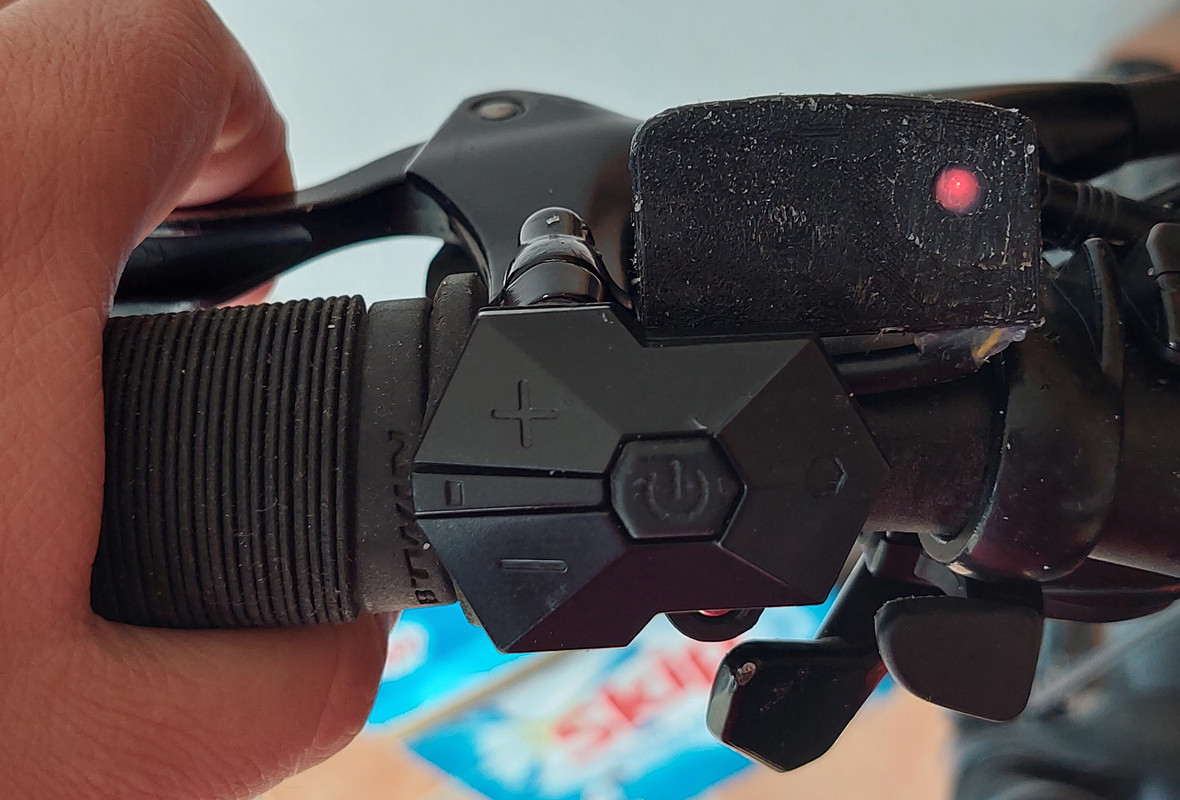

Our wireless remote already implements ANT controls / remote control for Garmin Edge and change the page. Will be easier for you to use the same board we are using which is not that one. See how to build the remote: https://opensourceebike.github.io/

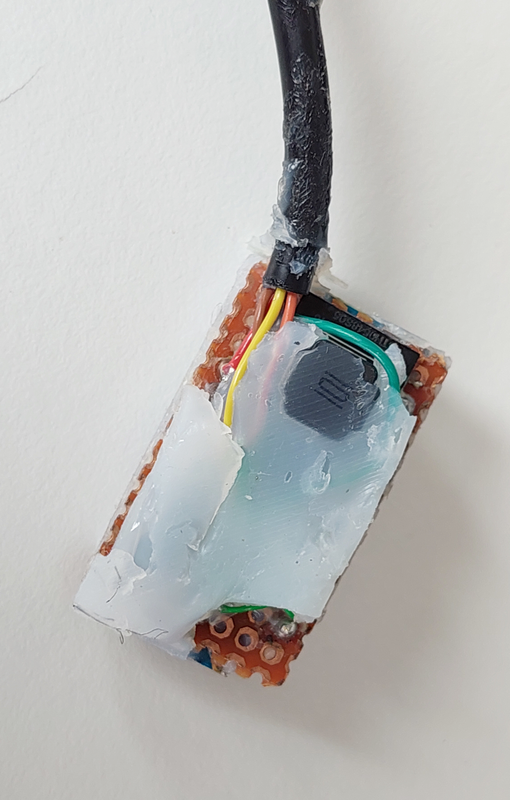

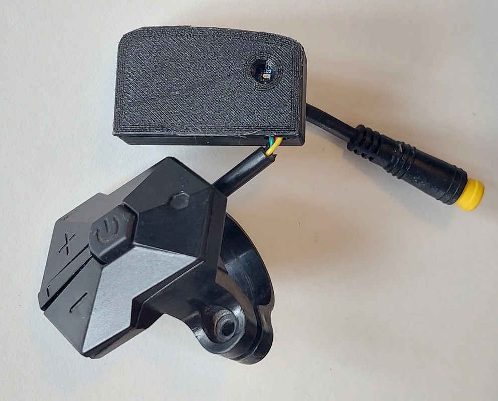

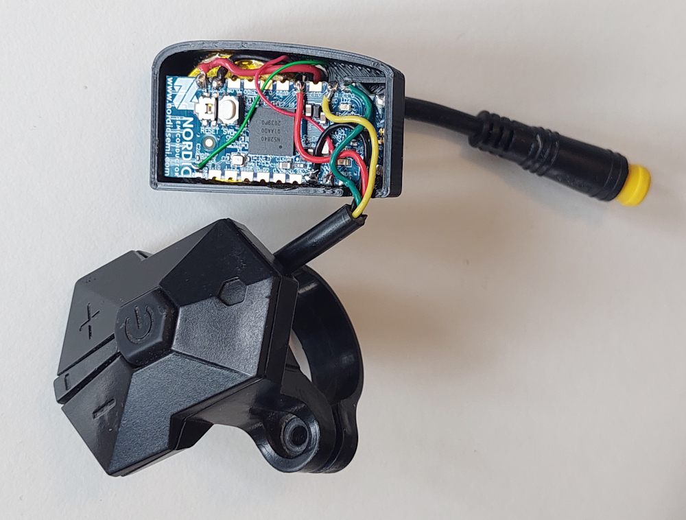

So I did the new design for the wireless remote. I like a lot the 850C keypad, it is easy to click on each button without error of clicking on any other, has good tactile and audible feedback, as also the right size (not to small and not to big).
The 3D printed enclosure is glued to the 850C remote and is very solid.
I don't think is possible to make it smaller. Although the battery may work for 1.5 years, I wish in a future version to add 4 small screws and a back cover so battery can be easily changed as it is now, probably we need to trash the 3D printed enclosured.
Here is the final result:
Before applying the white silicone, to make the box water prof:
And all the wiring done: 2 wires for battery; 2 wires for the brake sensor; 4 wires for the 850C remote:
And note that the white button is still clickable under the black box, as the box was designed to be thin under the button:

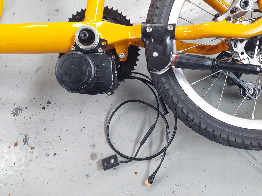

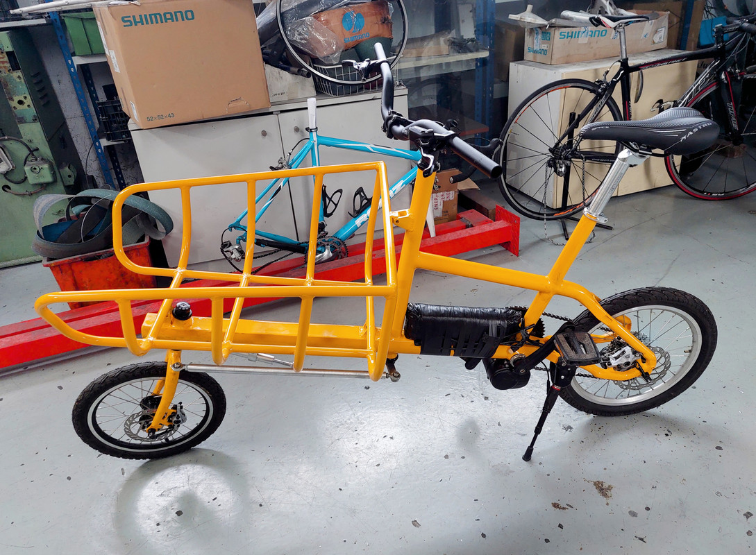

Because I have a new mini cargo bike almost ready, while preparing the motor cable to connect the TSDZ2 wireless, I did a mistake of power cables and the TSDZ2 wireless did burn, both DC-DC converter and NRF52 board stopped to work.
Here pictures of the TSDZ2 wireless inside, as we can see, it is fully water prof using the silicone:
Then I had to build 2 units and finally I had the both 2 big mosfets and they work as expected:
I also changed the cover, to remove the big hole for the button. Now the cover is thinner under the button so it is clickable - less working for assembling and even better design.
And here my new mini cargo bike is mostly ready, with a perfect fit for TSDZ2 :) -- and that is a small bicycle and I want it clean so using the wireless is perfect, less cables including no wheel speed sensor. I will make all that cables as short as possible as also a black 3D printed enclosure for the battery:
