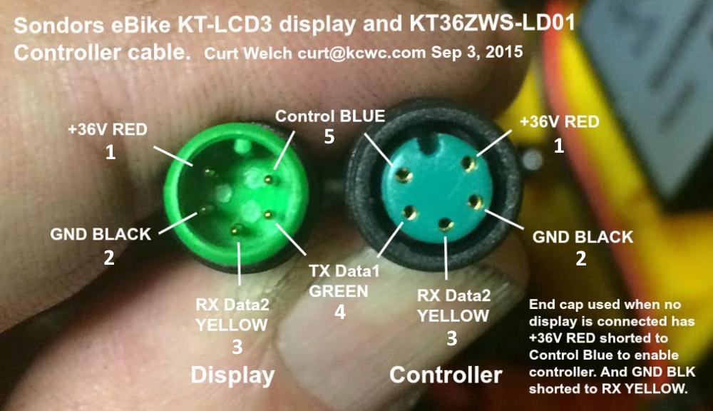

I climbed aboard the FOSS Firmware train yesterday (v19beta8) once I confirmed my system worked with factory firmware, and I'm very pleased. It gives me the bionic legs I was after, and should make my hot summer commutes much less sweaty.
I'm using it for urban transportation on my commuter bike with 3-speed hub; I changed cogs to raise my leg-power gearing +25%, and now I'm cadence-limited at ~25mph/40kph and with higher gearing could definitely cruise faster on the flat.
Q: Is there a project Patreon or equivalent for contributions? I would like to support the developers.
Flashing the motor with direct pin connection, as mctubster demonstrated is very easy. Getting that programming connection seemed a daunting step, but is actually very easy that way.
I may have misunderstood the LCD3 wiring instructions where it suggested buying a spare controller for connections. That hasn't helped me and I don't see how it would(?). As it is, I haven't needed any extras - just the LCD3 and TSDZ2. I have a spare controller now anyway, and I put the extra wheel magnet to use by installing two and halving my wheel circumference setting.
Initial observations:
I'm going to have to try the field weakening stuff, because it tails off much sooner than I would typically shift gears; I hadn't thought I was a particularly high-cadence rider...
With default settings, level 3 / 100% assist, I'm often pulling ~400W that feels quite intense. I can't help suspecting it over-estimates my power input. I'm likely to be adjusting the assist levels downwards. Initially I've been riding a lot at +100% for the novelty value, but it takes me through the gears and approaching the cadence limit in third very quickly with quite mild leg input.
The cadence metric seems over-smoothed, taking a very long time to catch up to reality. Perhaps that is a control input and deliberately done that way?
I have to add temperature and brake sensing soon. Keeping my feet off the pedals at the lights is a PITA, and I want to be confident I'm not overheating it.

Hi, I am newby on this forum and I follow this topic silently for a very long time.
I installed a first TSDZ2 + XH18 on my daughters bike (still standard fw). I loved it directly and bought a second set to rebuild my bike from to hub motor with pas sensor to TSDZ2 + P850C display and brake sensors (still standard).
Now that my battery is fading, I want to give the FOS a try, it's however a big step. I already managed to reprogramme the LCD3. I intend to make an interface cable between original LCD3 connector and the TSDZ harness display connector.
Based on this picture (I added pin nrs)
I was wondering if somebody can confirm if underneath pin-to-pin interface cable is correct?
Thanks in advance for feedback and a big thanks to all the people contributing to very nice project.
The pin mapping for the KT-LCD3 to plug into the 1to4 harness that came with your TSDZ2/850C is as follows:
KT-LCD3 / 850C
Blue / Orange
Green / Green
Yellow / White
Black / Black
Red / brown
This is the same as Bafang display wiring. Your motor probably has a female 8 pin connector and your daughter's has an 8 pin male or a 6 pin female. If your daughters motor has an 8 pin male you can convert her motor to be compatible with this same wiring using a special 1to4 cable I had manufactured that converts a standard TSDZ2 8 pin controller to use Bafang style wiring so you can use all of the Bafang throttles and brake sensors. Also, very soon, thanks to the talented engineers working on this project, you will also be able to flash the 850C and the new BlueTooth SW102 displays and they are compatible with this cable as well. You can find it here: https://www.electrifybike.com/store/p116/1_to_4__Female_Cable_for_TSDZ2_FOS_Firmware_Upgrade.html#/
