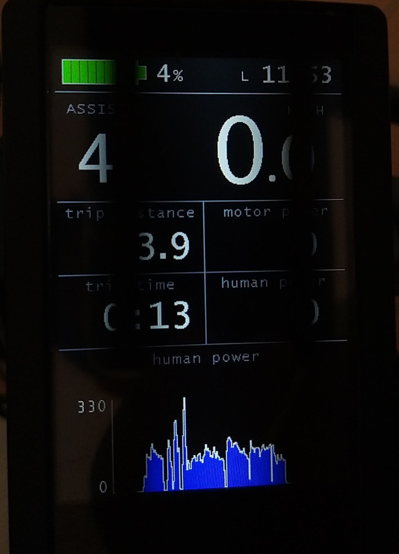

I just released the very first working version for Bafang 850C LCD -- follow the guide on wiki to know how to wire to TSDZ2 motor and download and flash the firmware: https://github.com/OpenSource-EBike-firmware/TSDZ2_wiki/wiki/How-to-install-the-Flexible-OpenSource-firmware
Note that black vertical lines are due to the mobile camera recording frequency.

I have flashed my Bafang 850C screen successfully and compared the data on the screen with the firmware bin file so i am 100% its correct. however i cannot get it to power up at all, it's been blank ever since. Can I check if there is no UART to the motor would you see anything on the screen to show an error or would it remain blank?
I am wondering if i have reversed my TX/RX connections from my early experiments, but before i hack my cable i wanted to be sure what should happen if there is no coms to the motor established.
I have been using STM32 St-Link https://my.st.com/content/my_st_com...ent-tools/stm32-programmers/stsw-link004.html windows tool to flash but it all worked as expected. but maybe I have done something wrong during the flash?
