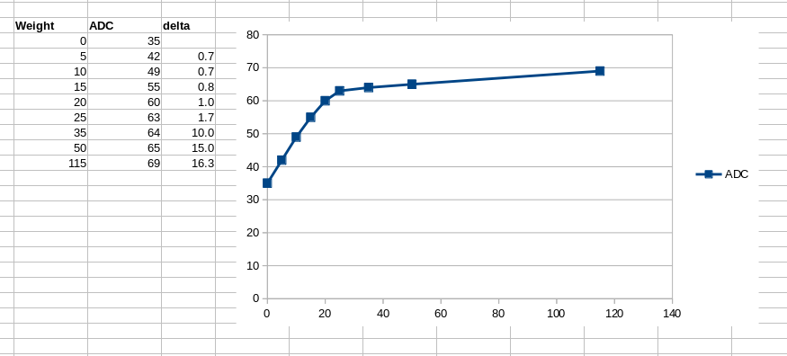

This is the graph of my torque sensor and follows the same as presented before by another user (and I though I did a good calibration but in the end, it starts at 35 while it should start at 25).
Anyway, were is the graph. I used a fixed weight of 15 kgs to be able to measure up to 50 kgs (did max of 35 kgs with my arm). The last value of 115 kg was my weight + the 15 kgs and that makes sense to me. Max measured value was 70 of unknown weight.
Interesting that there are two seemingly linear regions. So theoretically possible to have a lot of range with the torque sensor if calibrated correctly.

We also need ADC 10 bits value and not only 8 bits, as it should improve the resolution from the 15 kg / ADC unit to 3.75 kg / ADC unit on the high end scale.
Already switched to 10 bit values in my development version so am glad you feel it will be better. Can confirm it already works much nicer!
