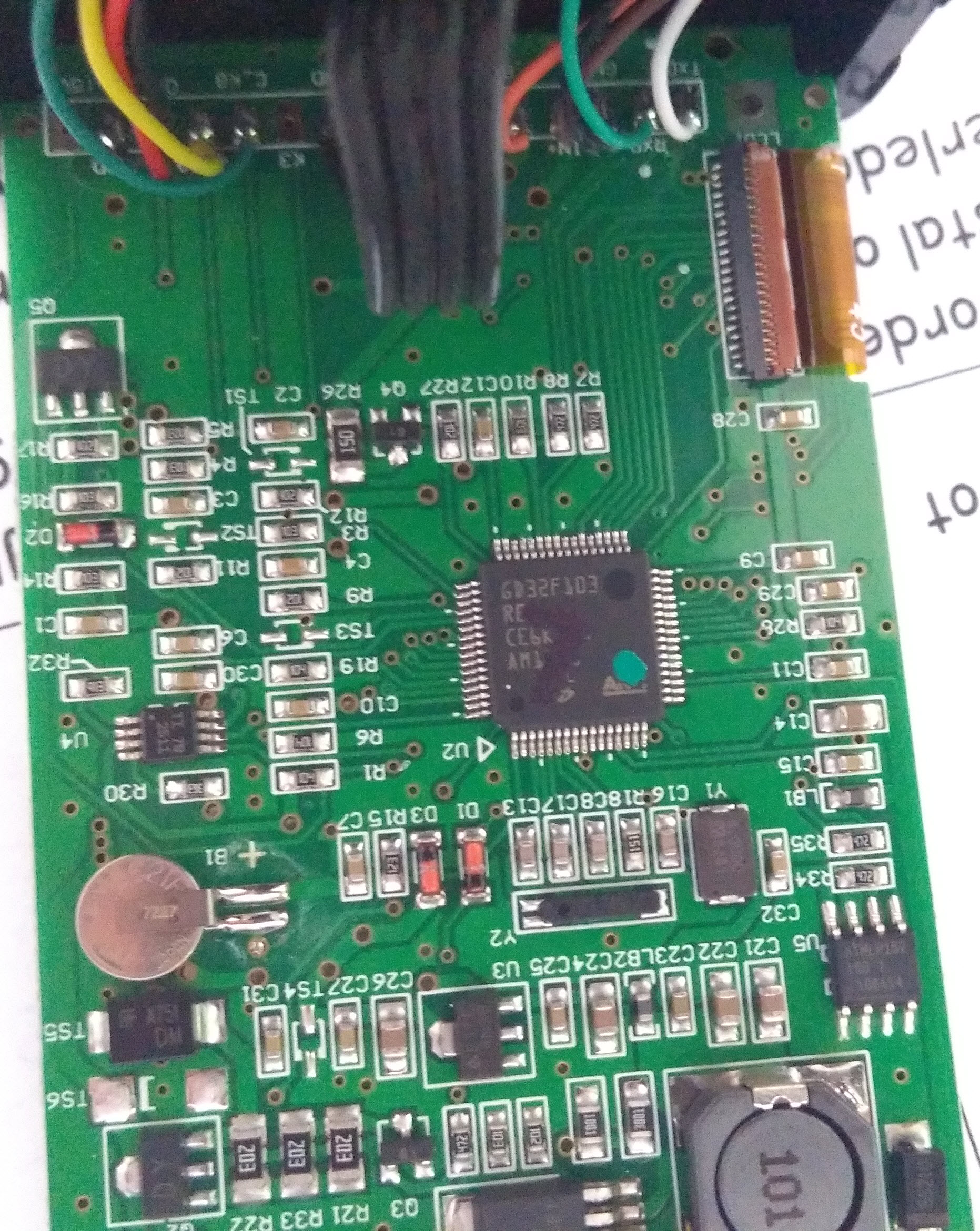

So you would think that the issue must be within the screen?
luckily I had another screen on another bike so i could quickly test that and exactly the same the screen shows around 45.5V and jumps around a couple of volts. Also you could clearly see the back light would flicker and dim when the battery voltage was dropping (still st 44v)
