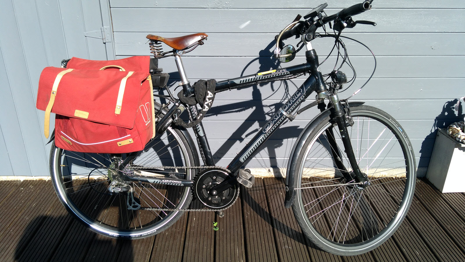

1. we did arround 52km in total
2. I have 10S5P 36V 17.5Ah battery
3. had +-297 Wh used
4. worst case, the motor delivered arround 620W
5. Standard city bike, have recently installed a 52T front sprocket. I have been riding 6 months standard sw, and now already 647km with 0.19 & 20.
Well, since the OSF bike did perform much, much better then the Bosch and hub-bikes, I could ride upfront and was photographer on duty

How could you climb a 20% slope with a 52t chainring? :shock:
You must have iron legs :mrgreen: .. or you just used constant 600w? Looks like you miss the right gears to climb that slopes.. and maybe Bosch systems couldn't supply more than legal power, that's why perhaps they couldn't make it to the top.
Did you check the heat of the motor once you reach the top of the hill?

So your battery has 600 Wh and you used half of it.
Note that 620W at 36V is 17 amps, it is safe if for short periods and I suggest the temperature sensor so our firmware can automatically manage the motor max temperature VS motor power.
And yes, I also use a 52T to be able to ride at 45 / 50km/h in the flat roads. For climbing, I use the second plate of 34T and 40T at rear, otherwise I would have to climb very fast like at 12 kmh/s while I do 6 km/h, so, twice the torque.
