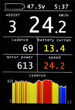

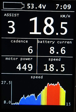

Trip is considered to start at every system boot.Bourtin said:After 1300 km with the original firmware, I installed version 0.19 with display 850c and version 5 beta7.
It's great, it seems to me that the engine is less noisy, very versatile for both settings and information.
The distance trip and the odometer are reset to zero when I turn off the display. Is this normal operation?
I like toting the mileage on an entire battery discharge.
Odometer has that issue you say. Will probably make an option on configuration to see and edit (like reset) this value.
