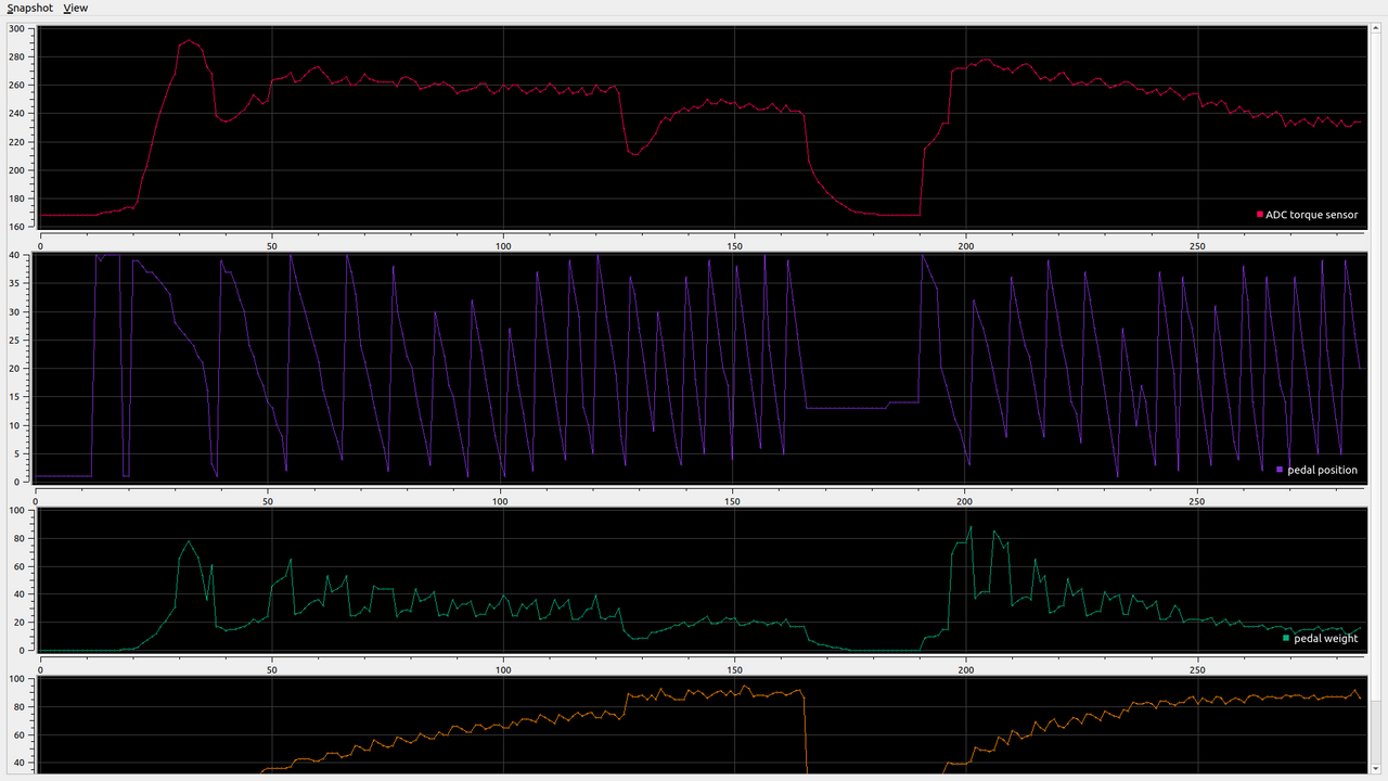

Are you sure that the cadence is not the 4th graph and the weight the 3rd one?
Thanks!! You were right and here another log now with correct variables labels.
What I see clearly wrong are peaks of calculated weight on the pedals. This peaks are way more than the values regarded to the ADC, I mean, the ADC value is the input to the calculation and the weight the output, and this output is clearly over what should be, so, I will look at the code to try find the issue. This error peaks are bigger at low cadence and reduce to almost zero at higher cadence like 80 and 90 RPM.

I don't know but I think at low cadence the weight on the pedal is high when you push on the pedal, and low when the pedals are in the dead zone. When you increase the cadence you get inertia and the weight is constant through the rotation.
I don't think there is anything wrong with your graph.

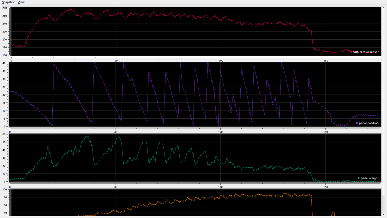

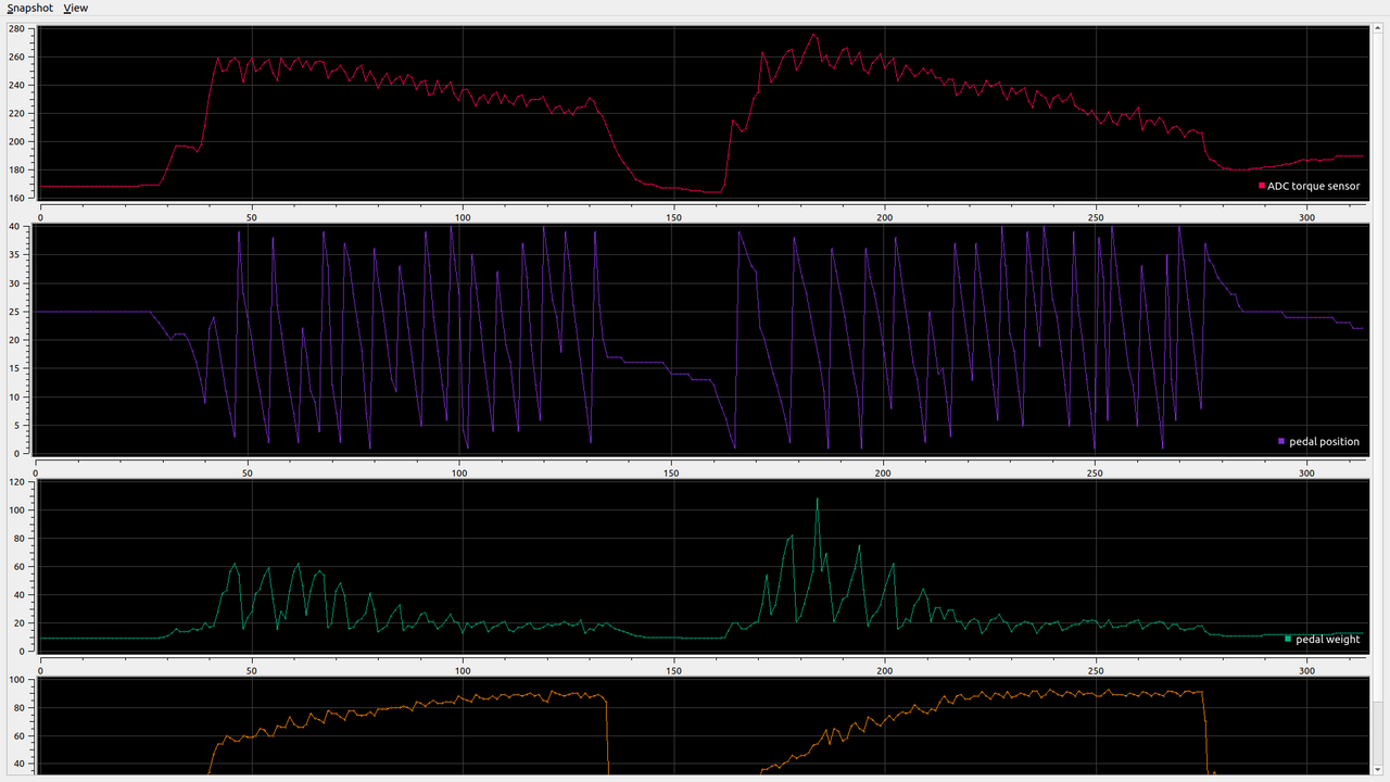

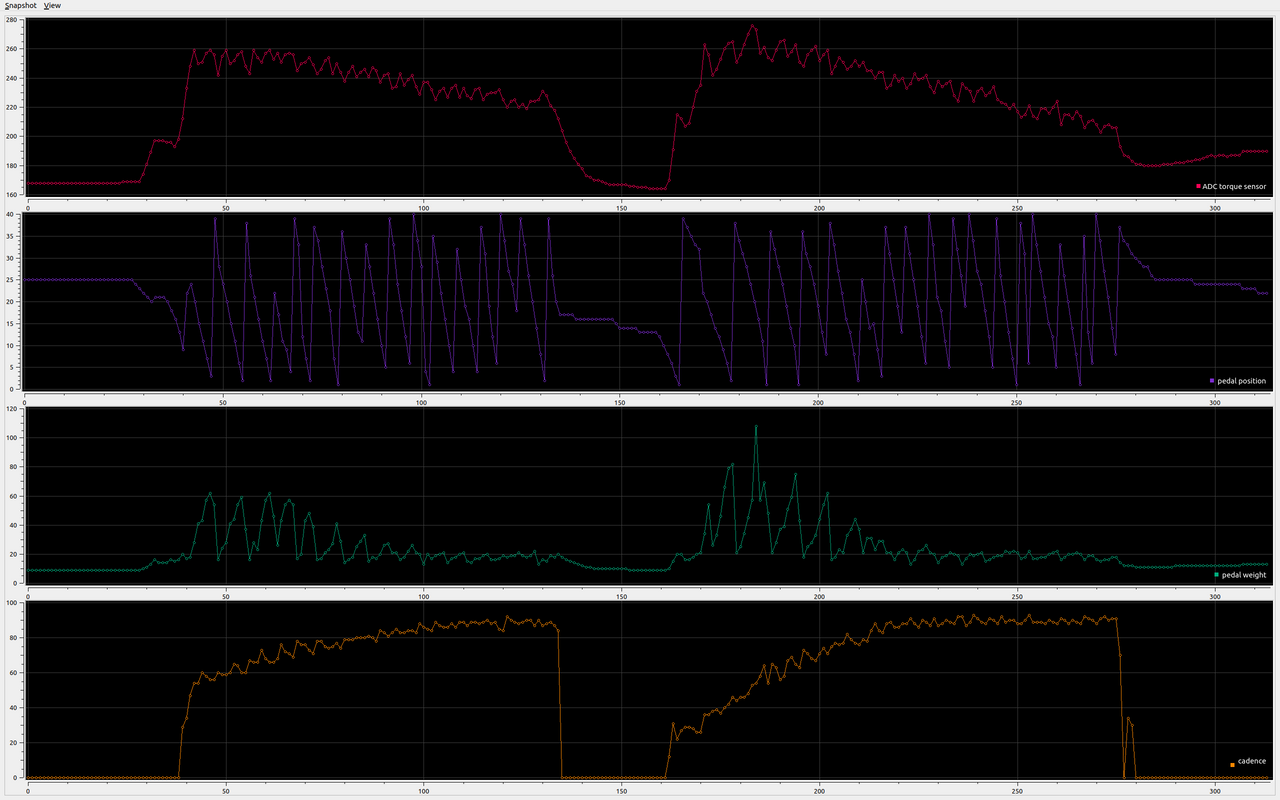

agphil said:
For example, if you would do the same measurements when climbing standing on the pedals at 50rpm, I would expect huge peaks in the weight graph.
I was testing again the code that calculates the weight on the pedals and it is ok. So then I started to make 2 different readings of the torque sensor signal:
1. regular measurement every 50ms independent of the pedal position
2. measurement every moment the pedals are in horizontal position (2 times per each 1 RPM)
Than I mix the signal 1. and 2. in a proportion defined on configuration "torque sensor filter", from 0 to 100%. Where 25 is 75% of the signal for 1. and 25% of signal 2..
I could not test for long rides but seems to me that a value between 20 and 40 is somehow good. On a value of 60% I note a lot of delay... here are logs of the signals I took:
Filter = 0. Note peaks of weight of 80 and 110 kgs (green line), these are correct because is was pedaling out of the saddle - these measurements are only possible with torque sensor calibration otherwise the torque sensor will never measure them:
Filter = 20. Maybe this is a good value:
Filter = 40:

Why not implementing a simple digital filter or a moving average on all the measurements?
something like weight = A*weight(n-1) + B*weight(n) with A+B=1
or for example a moving average with 3 points: weight = (weight(n-2) + weight(n-1) + weight(n))/3
Your single sample when the pedal is horizontal seems to introduce a lot of noise in your calculation.
