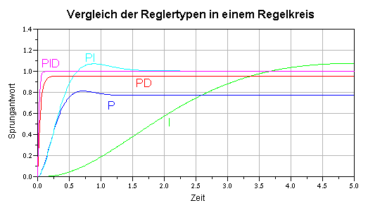

casainho said:
1. we should implement a current ramp and not a duty_cycle ramp.
Why don't you use a PI-controller for the battery current, like we do in the Kunteng project? With this you can adjust the response time very easily with the parameters Gain_P and Gain_I...
Code:
uint32_t PI_control(uint16_t pv, uint16_t setpoint, uint8_t uint_PWM_Enable) {
	float float_p;
	static float float_i;
	static float float_dc = 0;
	float_p = ((float) setpoint - (float) pv) * flt_s_pid_gain_p;
	float_i += ((float) setpoint - (float) pv) * flt_s_pid_gain_i;
	if (float_i > 255)float_i = 255;
	if (float_i < 0)float_i = 0;
	if (float_p + float_i > float_dc + 5) {
		float_dc += 5;
	} else if (float_p + float_i < float_dc - 5) {
		float_dc -= 5;
	} else {
		float_dc = float_p + float_i;
	if (float_dc > 255)float_dc = 255;
	if (float_dc < 0)float_dc = 0;
	return ((uint32_t) (float_dc));
regards
stancecoke
stancecoke said:
I am not a big fan of PI controllers, I prefer the ramp approach. If I find more value over ramp for PI, I will implement it. Do you know an advantage of using a PI controller (for this current controller) over a ramp?
The advantage ist very clear, you get a much faster and more natural response with the PI-control (turquoise green plot).
Your implementation is a pure I-control (light green plot). With our experience, you don't need an extra control in the fast loop.
regards
stancecoke
Ah, I see. But I don´t like that approach having current controller on slow loop, I really prefer it on fast loop and on motor.c. Users are playing on ebike_app.c and that way are not making issues with the current controller, that I think otherwise would result in burned motor controllers.
The current controller on fast loop is faster 1562 times compared on slow loop so I think it does not need a PI controller. What may be missing is that ¨natural response¨, but in reality seems that users may prefer a fast response from the torque at the very first time. Maybe the ¨natural response¨ would be good for speed controller, as I think for speed it should be soft for cutoff on max speed limit.
Well, I think there are other things to improve yet before start experimenting with speed of softness of motor response for torque and or speed. On that time, I will for sure look at your code and graphs ;)

2. implement: current ramp AND PWM_DUTY_CYCLE_RAMP_UP_INVERSE_STEP at a lower value maybe like 10
3. Let´s say we set our target current to 10 amps and the current ramp increases 1 amp per each 0.1 second, so after 1 second the motor ends at 10 amps but the current/torque stress on gears and mechanical parts increase with the ramp from 0 to 10 in 1 second.
4. At the first step on 0.1 second, the current ramp controller will set current to 1 amp and duty-cycle will jump very fast on that 0.1 second to get 1 amp and that should make motor rotate very fast to the desired final speed and engage the gears but using that low current... -- I think the result is what we all would like to have: fast response but not with an abrupt torque!!!
