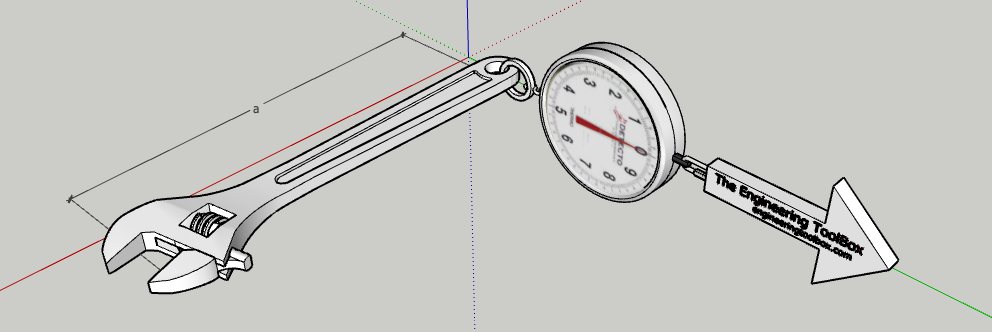

I used this information:
https://www.engineeringtoolbox.com/torque-wrench-luggage-scale-d_1909.html
Improvised torque wrench with luggage scale
If you don't have a torque wrench available - or if you want to check the readings of the one you have - it is easy to improvise by using a standard wrench and a scale as indicated in the figure above.
The moment - or torque - can be calculated
T = F a (1)
where
T = moment or torque (Nm, ft lbf )
F = applied force (N, lbf)
a = length of the wrench (m, ft)
Note! - Most scales in the SI unit system measures weight - force due to the acceleration of gravity - in kg.
the difference between mass and weight.
The reading from the scale can be converted to N by using
F = m g
where
m = reading of the scale (kg, lbf)
g = acceleration of gravity (9.81 m/s2, 32.17 ft/s2)
Example - Measuring Torque with a standard Wrench and a Luggage Scale - readings in kg
The reading of the scale at the end of the wrench is 10 kg. The length of the wrench is 0.3 m. The moment exerted can be calculated
T = (10 kg) (9.81 m/s2) (0.3 m)
= 29.4 Nm
Example - Measuring Torque with a standard Wrench and a Luggage Scale - readings in lb
The reading of the scale at the end of the wrench is 20 lbf. The length of the wrench is 6 in. The moment exerted can be calculated
T = (20 lbf) (6 in)
= 120 lbf in
= 10 lbf ft
Once you are familiar with the torque at different revolutions per minute (rpm’s) the power is easy to calculate. The formula for power calculation is:
P = τ x n x 2 x pi
τ = Torque
n = roations/ second
pi = 3,14
Thanks for providing the link. I had a feeling my calculation wasnt correct using Force instead of torque but all the units cancelled out.
So I played around with this today using a workout stand. Also spent a few hours looking at the code and am convinced myself power calculations are correct(minus a few small errors like using 9.18 for conversion kg->n instead of 9.81). Not sure why I seem to see higher values on the road than I expect, perhaps I push harder when I look down :eek:
I think what I am seeing (correct motor output corresponding to assist levels and human power, diminishing at higher human power levels) is that I am running into the motor rpm limits (48V motor and 48V battery). I get my power from spinning and couldnt seem to easily get to 90rpm (from the advanced technical data submenu), The harder I pushed against this limit the more the expected motor output didnt match my input+assist). Basically with assist at 3, at 150 watts of my power was about 450watts from the motor. When I went as hard as I could(same gear and asist level) this changed to about 400W human power and about 200W motor power.
