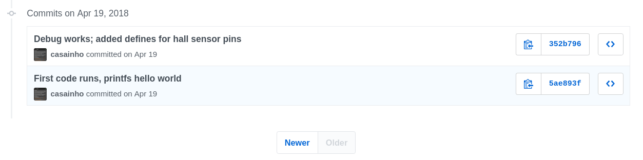

Thanks. And I started this project on April and in 2019 will be the first spring that I will be riding on mountains that I like so much and that I never did before -- ebikes and in particular TSDZ2 really improved my life (also for my family members!). I am happy that this technology will also improve the life of others on the new year!!
I don't know what will happen to ebikes but I already started to looking at my next project, something that may take 10 years or more and that I did discover the need using TSDZ2 on mountains!!
