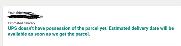

I can't stand this, items I ordered from CHINA, orders I made AFTER the one with Enerprof, have arrived yesterday... and the tracking link I got from this German company still points out they haven't even gotten my parcel yet.
Absolutely disgusted, will NEVER EVER place an order there again nor would I recommend anyone from ever using that buisiness for anything. I already steered clear fpor the most part because of their high pricing, these displays being the exceptions probably because there are no others like it.. and this time they were on clearance sale...
But c'mon, China shipping me a groupset, bikelight, grips and some new valve caps.. and it arriving before a single display from my neighbouring country in the EU... this is just a complete lack of customer focus. Especially considering I had to mail them to even get a shipping link... 'we ship on Monday' ... except even NOW dhl doesn't even have a parcel...
Disgusted. Sorry just can't express this feeling in any other way. Schermafbeelding 2025-01-01 145620.png
edit: ... and today instead of my parcel from Germany I ordered before the orders from China which have all been delivered long ago... I got another email the estimated delivery has again moved to after the weekend.
You can claim 'it's still the holiday season' but all those CN sellers are using the same last mile delivery options a company from Germany has.
So, not only prices which are 'reflective' of someone who wants EU wages but that coupled with subpar service. Never again.

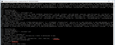

Hello, can you tell me, what is this error in the configurator program? As a result, the firmware file has not been created. How can I fix this error?
I think I ran into that error when I had a misconfigured path variable.
I installed again using default paths and it worked. If you did already install using default path ignore me, if not give it a try.
Thank you very much. I figured it out, but I don't know how to set the default paths. Could you give me a hint?
I just uninstalled everything and followed the wiki to the letter can't remember exactly.
But st_toolset and SDCC are both installed in c:\ ( root ), and I have a folder in c:\ called TSDZ2-Smart-EBike-1-master where I downloaded the project files to.

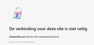

Screen finally came in just now... immediatly checked if it worked... DEAD ON ARRIVAL GRRRRRRR %#%@#$%@#%
And then you want to make an RMA... and when I try to open anything on enerprof.de ...
Not sure but I don't think this is on my end? Using Edge, latest update, as well as Opera...
I'll start the RMA through mail then I guess.. omg what a terrible experience enerprof has been, once and never again they can keep their friggin displays which were the only thing there not a ripoff anyway and put them up their backside.
edit: would appreciate it if someone could check for me is the SSL error is on their end or if it could still be on my end ( misconfigured date?? though I haven't touched/changed those settings ever since selecting my time zone during windows setup ).
edit2: Guess not...
Seriously... China is in reality a more reliable business partner it seem then Germany🤮
edit3: they insist per mail they check all displays when they get their inventory in... off that means nothing to me, but I will take another look.
