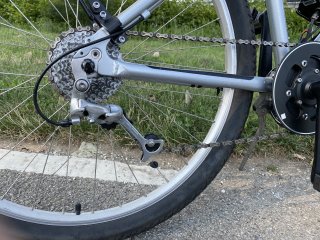

For 500 miles, I had a TSDZ2 in a an old 1987 Raleigh Mtn Tour Seneca with 6 spd freewheel and the rear cogs worked well with no issues. A few weeks ago I moved the mid drive to another old Raleigh (2000 M80 w. very little use- practically new). It has a freehub 8 spd cassette and the bike jumps in and out of gears often. I tried adjusting the rear derailleur and cable tension which didn't help much. Maybe I'm not doing a good job with the adjustment?
I do not use the highest and lowest cogs and have adjusted them out with the hi/lo limit screws. I use mostly cogs 3, 4 and 5, those are the gears that jumps. Say I'm in gear 3 and pedaling, I hear a clunk, feel loss of resistance on the pedal for 1/4 of a revolution when it shifts to the next higher or lower gear.
Very annoying! Any suggestions? Keep adjusting? Get a 6 spd cassette? Get a different derailleur/ shifter?

Take a look at the position of the lower jockey wheel of these 2 pics, on the smallest and largest sprocket. Do you still think the chain is too long?
Doesn't look too long.
Do you have a bike shop nearby? they could help diagnose this!
Could the chain be too short? With chain on the largest sprocket, shouldn't the jockey wheel/ pivot arm be pointing vertically down to the ground, and not toward the chain ring like in the pic?
It looks okay. Its similar to the picture on the park tool website.

My derailleur alignment tool from Aliexpress finally showed up yesterday. I mounted the tool on the hanger and found the hanger was slightly bent at the 6 o'clock position (tool arm was 1" inwards past the rim). I bent it back with the tool and was surprised it didn't take much force. The hanger must be made of very soft steel to protect the derailleur. The jumping in/ out of gear issue is gone and it's shifting much better now.
