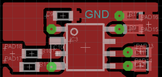

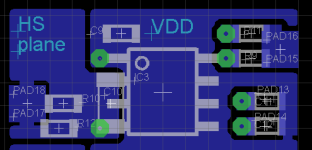

zombiess, R10 at pin 3 of the IC is the high side output gate drive, that's on the top layer where I also have my GND plane. Below R10, R12 and a part of the GND plane, I have the HS plane, HS is high side source. The HS plane is overlapping the GND plane, is that a bad idea? After you mentioned the noise issue, I can see that the HS plane should probably not be bigger than the high current path for the gate, on the top side.
That is the concept I was talking about. The 2 ground planes should not overlap.
Are the green dots vias? If so it looks like you have a lot of them for so few components. Can you get all the components on the top?
Yes, the green are vias. I could probably get all the components on the top side, but the board would become larger and hence some of the gate traces would become longer.
What would it benefit to get all the components on the same layer? It would not decrease the number of required vias.
I would really only be able to eliminate 1 via, which I think I will, but only by putting C11 and C12 on the top side, and I will change those to SMD 0603 so it won't affect board size.
