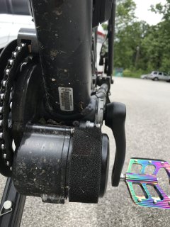

An additional note for air-cooling modification. I got caught in a slight rain shower yesterday and thought front wheel would throw water and get the motor wet. It turns out the motor is offset to the left of the frame and not in direct line with the front wheel as evidenced by road worms and crud on the front of the downtube and absent from the filter media covering the large vent holes in motor cover...
...air-cooling modification. I got caught in a slight rain shower yesterday and thought front wheel would throw water and get the motor wet. It turns out the motor is offset to the left of the frame ....

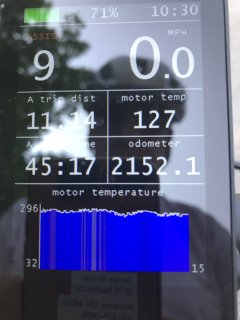

See post #299. Another ride with air-cooled motor….. I rode 15 miles today on the flat with outside air temp 80F. Average speed was 18 mph. I used highest power level 9 which I have limited to 450 Watts. Cadence was about 90 in slightly lower gear. Scale on graph is off by 2x. Actual max motor temp was 148F.
