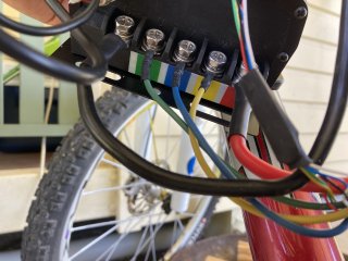

I’ve just installed the motor for the first time.
The motor doesn’t spin, just shudders when I apply the throttle.
Could anyone suggest what is wrong and how to fix it?
The wheel spins fine when pedalling or spinning it by hand.
Any help would be appreciated. Is there any installation guide online?
Thanks heaps. It seems I’ve got things connected to the right place? That article is a little bit more detailed than my understanding level but I’ll get out the multimeter and do some tests.
Edit: the controller is a Sabvoton SVMC7260. Does the wiring at the motor look ok? Seems the shrink wrap has maybe come off in parts. I’ll start testing

So the problem is that for this controller from Sabvoton the wiring goes
Black - Black
Blue - Green
Green - Blue
Yellow - Yellow
Red - Red

All good, sorted now that the phase wires are connected in the correct (non colour matching) order.
I have a 30H communication error now so will troubleshoot that, but the motor is running. Wow. The power is no comparison to the BBSHD etc.

Does it have a self-learn or autotune function? Many controllers do these days. Some are a wire pair you use per the controller instructions, and some are activated by an app or computer program. If it has this it will find the correct wiring for you in most cases, changing internal settings so you don't have to mess with physically moving wires around.
Also, if it's an FOC controller, you probably have to use the app or computer program from that company to set up the controller for your specific motor, battery, etc, for it to perform correctly / as desired.
That plastic outer sleeve is somewhat protective but the main thing is to secure the cable so it cannot come into contact with the brake rotor screws, or any part of the rotating rotor for that matter.
Also, next time you remove/replace the wheel, orient the axle so the cable opening is facing downwards instead of upwards, to minimize any chance for water to drip down into the motor thru the axle opening. And leave a slight cable loop downwards (called a drip loop), so any water accumulating on the cable drips down from the lowest part of the drip loop instead of being carried into the axle
