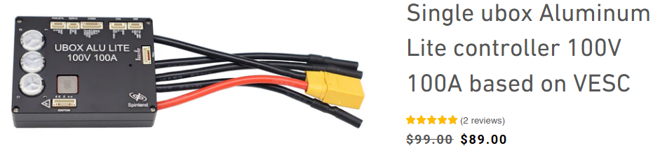

Hey Neptronix, I've been looking at VESC. Looks like you used this board, is that correct? Kind of looks like you can go without this board if the VESC can receive brake and throttle input like this...
single_ubox_100v_for_diy_escooter_application1_41405c77-8676-449c-8b32-97b8e164915c.jpg
Just curious why the ADC board would be used when you can connect right to the VESC. I do see the note about the 10k resistor, maybe that, alone, is reason enough. Or maybe you have a totally different board strapped to the VESC.
Yeah, i bought the ewheel adapter because i wanted a brainless plug and play experience. I haven't fully utilized it though ( it would be nice to use the 3 speed switch function )

Yeah, they aren't a thing. You do one of three four things:
1) Wire it to 3.3V+ line for positive (every hall throttle I've used has been fine with this.)
2) Wire up a voltage divider to scale the 5v down to 3.3v range
3) Use the adapter thing (which is, basically, #2, but already done for you)
4) Screw it and feed the VESC the returning 4.2v on the ADC1 -- some controllers will fry at this, but quite a few are built to actually handle this. The controller will not see the voltage above 3.3v (so you lose a lot of throttle range), but it doesn't fry the board either.
I've done every one of these methods.
