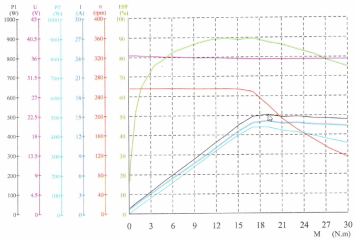

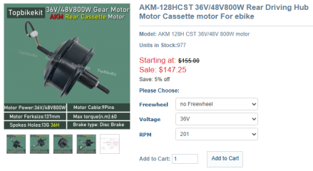

2.82kg or 6.2lbs and 800w rated... traditional gears... maybe 80% peak efficiency if the Q128H graph is to be believed
2.4kg or 5.3lbs, roller gears, very high efficiency and >500w rated if the p100 efficiency graph is to be believed.
The old Q128H graph from 2013 shows 79% efficiency peak, but it's from 2013. I imagine this was due to 0.5mm laminations being used at the time. I asked two sellers of it about lamination thickness is 0.35mm yet. this factor will break the tie.
I'm a little worried about the durability of a roller drive setup, especially since i want to run higher than 36v on either motor.
I think if i find out they're still putting 0.5mm lams in the Aikema, i'll risk it on the Keyde.
