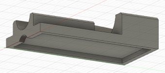

Hello, yesterday I sorted out (hopefully once for all) one thing left from my installation: a pretty stable solution to fit the brake sensors on my Magura 5 brakes that, due to their weird shape, did not offer a plan surface to attach the sensors in a good way like my other shimano bike.
I sketched an interface to be 3D printed, possibly in PETG, to fit the conic hydraulic hose bend stiffner. It can be fitted in the little recesses on the cone to avoid any slippage.
The sensors are the typical rectangular ones with the bafang or VLCD5 plugs, for any TSDZ2 firmware release :wink:
I put two versions in the attachment, with and without sensor border. The first one is more difficult to print due to small adhesion area (maybe a raft would be beneficial) and the second gets easily printed without any support. In the picture you can see the latter.
Hope this can be useful to any other Magura brakes owner.
Casainho, feel free to put the files it in your WIKI repository if you want, for easier downloading by users.
View attachment TSDZ2 brake sensor interface.zip
Cheers.
