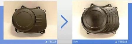

Is there an easy way to identify a “TSDz2B” from the original TSDZ2 ..?
anything external physical difference ?
or any clues in the sticker model or serial numbers ?..
Which one might this be ?
