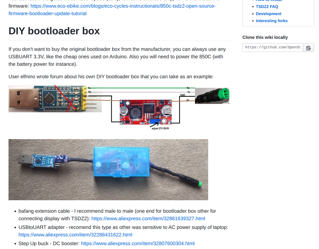

Any chance you can share any information on your successful set up? I'm looking to do the same.
No problem this is my final well working set up using "step up buck" instead of ebike buttery as power source..
The colors should match with bafang display cable
bafang extension cable - I recommend male to male (one end for bootloader box other for connecting display with TSDZ2)
https://www.aliexpress.com/item/32861639327.html
USBtoUART adapter - recomend this type as other was sensitive to AC power supply of laptop
https://www.aliexpress.com/item/32288431622.html
Step Up buck - DC booster
https://www.aliexpress.com/item/32807600304.html

Can you help to improve the wiki with this information?
elfnino said:
Yes I will try.
I went and pasted your notes and images. If you think it can be improved, please go ahead and edit the wiki:
