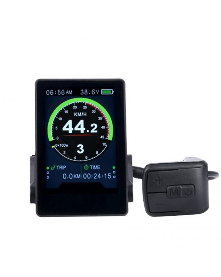

we bought it from the link below...
This looks a display specific for the Tsdz2 stock firmware.
Imho you can't flash this display version and must use it with the java OSF version for tsdz2 displays and flash the controller only.
we bought it from the link below, can we send you the display if you can test it and offer a correct program? we can pay .
The 860C versions with TSDZ2 protocol were never flashable.
I don't know if it depends on the hardware or the software.
The only possibility is to use the OSF version with the Java configurator and flash only the motor controller.
