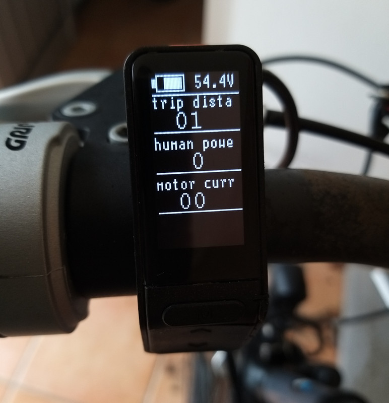

Second sw102 I ordered after frying the first, finally arrived after.
Successfully flashed as it seems "motor simulator" mode is running.
When I press the M button configuration menu appears but it disappears as soon as I release the M button.
So the configuration menu is visible only while I hold the M button. Is this normal or my unit is faulty?
bikelpl said:
Info screen 2 has only once entered the configuration mode for me.
I have the same.
I also noticed that, when You press M button and return to main screen , the assist level digit dissapears.
You have to press ^ or v button to change .
It is an known issue
Finished the SW102 installation with 0.19.17 display firmware and 0.19 motor version. Previously I used the VLCD5 marcoq firmware.
SW102 is nice and small, a little bit hard to read the motor watts. Down button does not work smoothly after cutting the keypad to install the firmware. I have experience all the issues commented here:
-trip distance and odometer do not have the decimal point
-the battery capacity percentage always shows 100%. I changed back to show the battery voltage
But now that the development of the SW102 has stopped I am not sure if all the investment to put this display worth it. I have bought 2 displays and the harness adapter from 8 pins to Bafang system....and at the end I prefer Marcoq firmware with the start ups configuration.
