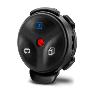

Maybe in future, instead of an ebike display, we could use instead our watches or cycle computers. There are also remote buttons. For the ones no wanting to use a display, then probably use only a remote button -- and both display and buttons being easily removal.
I think your project has a lot of potential, to make TSDZ2 controllable by, for instance, Garmin cycle computers. Then these computers could also connect to the remote buttons, Bluetooth BMS and lights.
Well, all of this is also possible to go with SW102 because it also supports Bluetooth and current implements the Bluetooth cycling profile you did mention before.
- cycle computers that can show ebike data as also control the ebike assistance with their buttons -- example Garmin Edge controlling a Shimano motor:
- remote buttons
I bet that Garmin watches can also work as a display and remote buttons:
- Garmin watches showing ebike data and will record your cycling fitness activity with data of cadence, speed, human power, etc:
