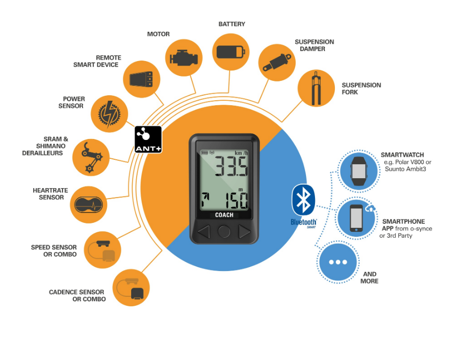

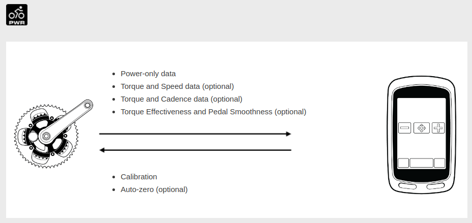

casainho said:I see. So on your handle bar you have 860C display and Edge 1000, which both have similar sizes and are big ones!!mallesepp said:Yes i use my edge 1000 also with eMtb with TSDZ2. Yes i wish that comunicate TSDZ2 with Garmin Edge 1000. It would be great for me if i get Data from TSDZ2 and Control it from Edge 1000. I use 860C Display. I have Powermeter on Race Bycicle. Its would be great if i get human power from TSDZ2 on my Garmin cycling computer.casainho said:So do you use your GPS cycling computer also on your eMtb with TSDZ2? If so, had you wish to have TSDZ2 sending data as a field and control it from your GPS cycling computer and avoid the TSDZ2 display?mallesepp said:I have two bikes! Roadrace and eMtb mit TSDZ2. Roadrace a drive fast and hard! eMtb next day to recover! I sent all my trips to garmin account! GPS cycling computer also i use for saved trips on it and follow this.
And which TSDZ2 display are you using?
I see you would have advantage in not have to buy 860C display and reuse the same display for both road and MTB bicycles, with the most important that is to have the same fitness metrics on both bicycles because you would be sharing the same Garmin device that measures them - yes, we can not expect the TSDZ2 torque sensor to be so good at measuring pedal power as a commercial pedals but I think it will anyway output some good approximation.
The way I see this happening for fully wireless TSDZ2 ebike (needs the implementation of a small electronic board and firmware, as also mobile app) :
1. Bluetooth mobile app for configurations
(firmware and mobile app development): use at least once Bluetooth mobile app to configure the TSDZ2 ebike configurations: the same as actual configurations on the display.
2. ANT+ Light electric vehicles (EBike) (firmware development): implements ANT+ Light electric vehicles (LEVs) profile that sends typical ebike data as also permits typical control of the ebike. Note that you need to have an ANT+ remote control on your handle bar and paired with your Garmin Edge to be able to control the ebike, like changing the assist level.
3. ANT+ Bicycle Power sensor (firmware development): implements ANT+ Bicycle Power profile that transmits Power-only data, Torque, Cadence and Speed data.
COSTS
Current costs for TSDZ2 with 860C display: 80€.
Option for MTB medium cost
1. Wireless TSDZ2 board -- 35€ and very easy to DIY: Bluetooth and ANT+, small black box and to be connected on the TSDZ2 display connector.
2. Wireless GPS cycling computer Garmin Edge 130 -- 150€.
3. Wireless Remote control -- 55€ (38€ the remote + 16€ the support).
TOTAL cost: +160€ compared to use 860C display. Only use this wireless option instead of regular 860C if user values the robustness of wireless (no cables to break on a fall) and the extra metrics given by the GPS cycling computer.
Note that if user may already have 2. and 3. and then the cost would be half then installing 860C display.
Option for most cheap city ebike, MTB, etc
2. Wireless Remote control -- 55€ (38€ the remote + 16€ the support).
TOTAL cost: +10€ compared to use 860C display. Only use this wireless option instead of regular 860C if user values the robustness of wireless (no cables to break on a fall) and probably a clean installation (good to avoid attraction to thieves, even because the remote can be easily removed so not way to start the motor).
The most small and cheap GPS display would be the Edge 130 model, that seems to be relatively small and have a very good reading at sunlight. It also have good specific mounts for road bikes and MTB:
[youtube]8mPWSEpaIBo[/youtube]
We can take much more value from Edge 130 than 860C display although the price is not much more:
There are on the market more options for ANT+ LEV GPS cycling computers (all of them will work!!) and there is one that costs 62€ - Coachsmart LEV:
