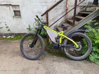

How to properly use the OS-ebike firmware and TSDZ2 controller v1 on another motor?
I burned three pairs of power transistors under similar circumstances...
1) 18s2p lifepo4 I was driving fast on a sandy dirt road and suddenly there was no traction. Knocked out three capacitors, two mosfets and a protective diode in the display sw102
2) I Replaced the controller. I rode on the gas stick, jumped off the curb, the wheel spun in flight, after landing everything went out. Knocked out the largest capacitor 63V and a pair of power transistors
3) 15s3p fully charged, 50V. I replaced the capacitors with 100 volts, replaced both power transistors. I ran over the curb and pedaled, knocked out the same transistors.
Please, help!
Is great to see someone using the TSDZ2 motor controller, our OpenSource firmware and the wireless controller, on another mid drive motor.
The issue you are having can be something due to that motor being different - it may have lower resistance and or inductance, and all the controller hardware and also the firmware are not ready for fast current changes on that type of motors.
Still, if you wanna try again, I would recommend to disable the Field Weakening feature. Also lower the motor phase current as also the battery current. Also reduce the current ramp value.
