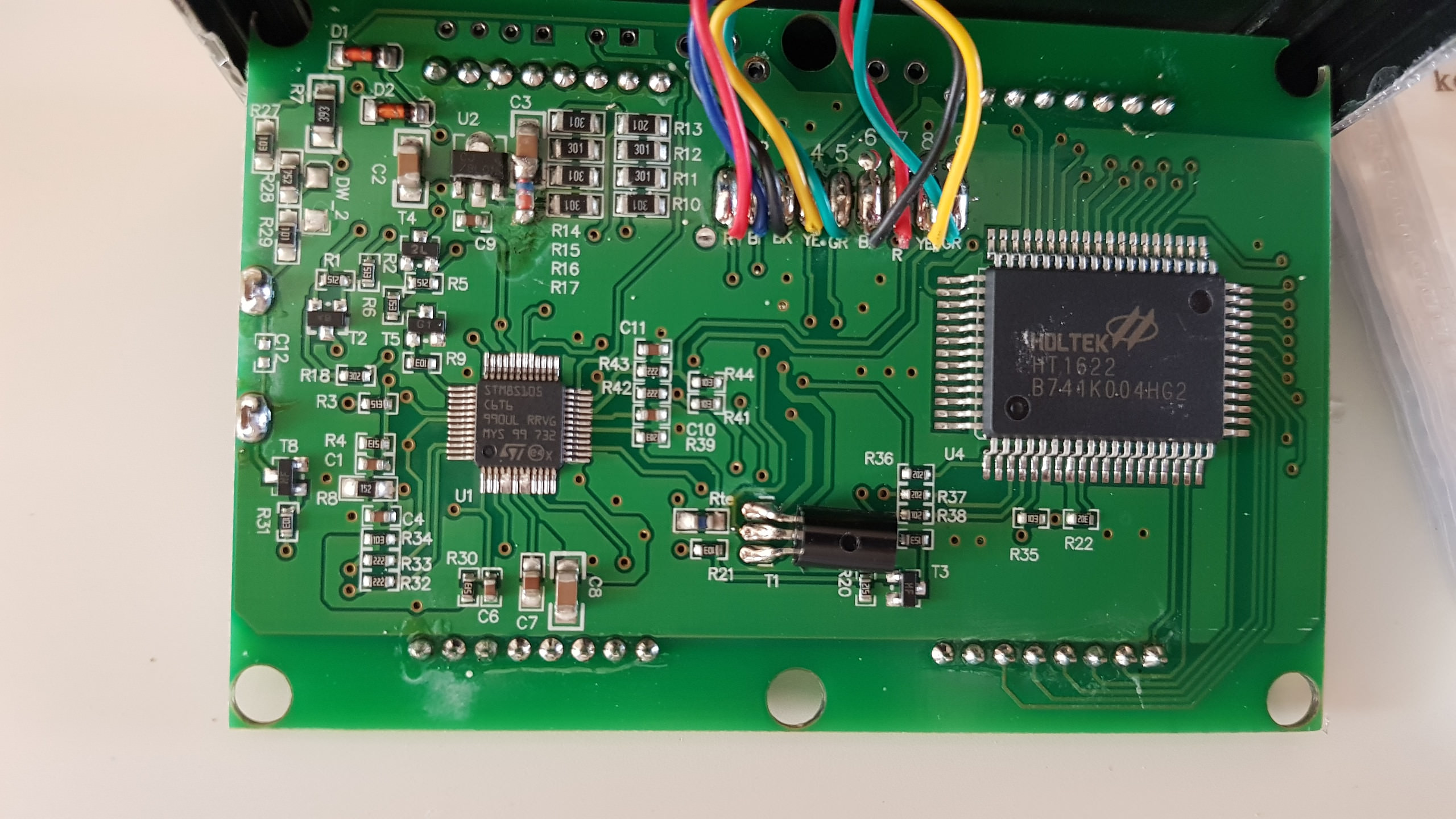

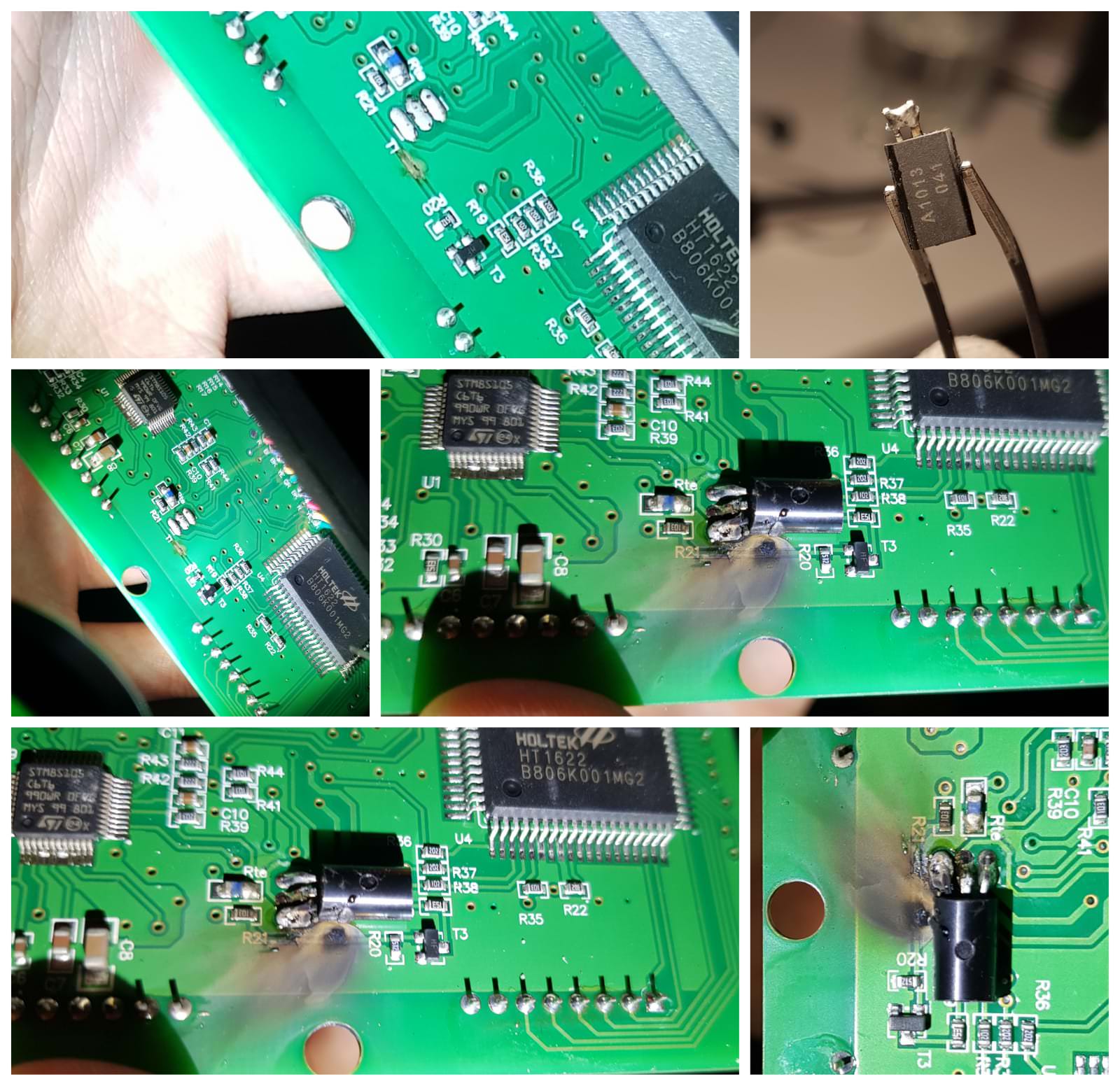

Hi everyone!
I burn my KT LCD3 :D :mrgreen:
I connect 48V version to 14s battery (about 58V)... Yes, I'm stupid...
When I look inside, I realised that only transistor is blow up (A1013). This is very cheap transistior for about 1$ on aliexpress... but I want to change this transistor to be compatible with my battery (42-60V). What should I choose? Maybe one of you has a 60V version and can check model of transistor? I would be very grateful!!!
Sztef89 said:
Hi everyone!
I think that transistor can hold 150V, looking at the datasheet. Also seems to hold 1A current. Can you please look at the resistors values and compare to the schematic done by Nieles?? See on https://opensourceebikefirmware.bitbucket.io/kunteng_lcd3/Development.html
I think that from 48V to 73V version, only that resistor change... But this is a guess only.

jernejtech said:
Sztef89 said:
Hi everyone!
Hello,
I was modify few LCD3. There are 7 resistors and some diodes, that you must changed/add and your LCD can work up to 20S.
Would be nice to know wh9ch ones and values. Tank you for sharing!!
jernejtech said:
casainho said:
jernejtech said:
Hello,
I did this long time ago so here are photo. Resistors from R10 to R17, R7 and R8 must be changed. So on this photo you can see values. And on C3 was added one zener diode.

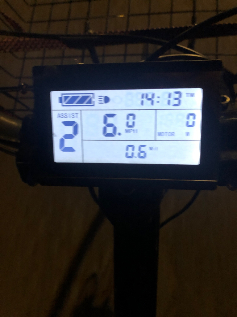

I have a problem
I have no power to my motor.
I was tightening the bottom bracket and (stupidly) compressed the battery wires ( possibly)as they WERE between the chain wheel side and frame.
Could this create a short circuit?
I had pulled apart the controller/ display connection. 1 of the pins was bent. I straightened it with a screw driver and it sparked (even more stupid)
When I turned on the battery the display started automatically. The asst levels changed with the on off button. I had No power with pas but throttle worked and speed sensor did not work.
I thought it may have been a software issue so I re flashed the standard software. Now no throttle and no PAS.
And with a fully charged battery only showed 1 bar. I was able to turn on and off via display button.
I now flashed the open Source Firmware 19 on a new 60v kt-lcd3.
All the functionality is working on the display including battery level and speed sensor is working.
No power of movement from the motor.
I would love to hear your thoughts and experiences!
Also how to wire the throttle into this system.
Many thanks
See on LCD3 if you get the correct information for torque senser and cadence.

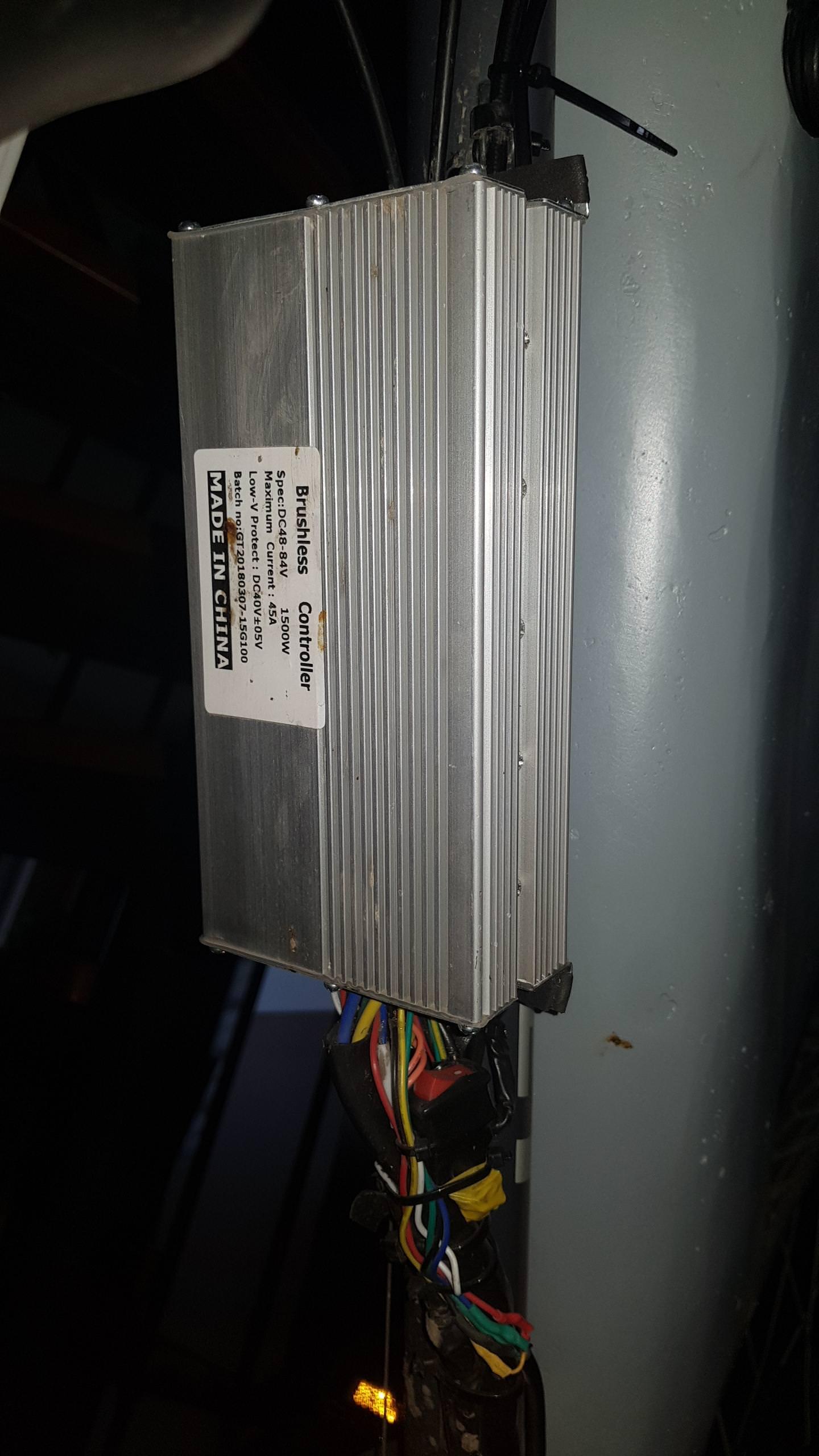

casainho said:
Awesome
I’ll try and let you know!
casainho said:
It does not look like it?
Só I would say the motor controller is dead.
Looks like it!!
