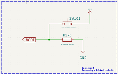

The controller recovery circuit has been reverse engineered.
Luna deleted this switch on the latest revisions because of that switch can be accidentally pressed by wires during installation the controller into the M600 case. But we can keep it for convenience and just simply cover it by a 3D printed cap or something to protect if from accidental actuation.

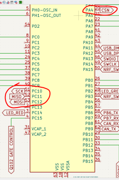

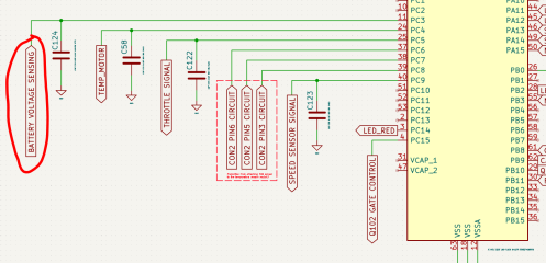

Hmm thats strange, why they played with temp sensor connector and using unused pins. Could be also prepared for normal 3 stator halls as it goes to STM. If this is the case and was prepared for 3x halls then more just like pull up resistor than voltage divider. Just 10k resistors to STM pins 3,5,6 I find quit high. Lets see if rotary magnet sensor U104 is working.

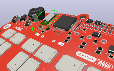

The rotary magnet sensor circuits have been reverse engineered!

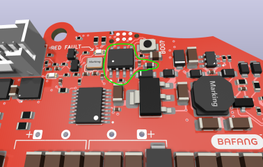

Almighty guys, we are getting dangerously close to finishing the schematics. Now it is time to complete the reverse engineering of the the power stage. If somebody knows a neat trick figuring out the Kelvin Connections without using soldering iron please let me know.
What is the chance these two vias are Kelvin Connectors? There is the same pattern on all three phases. Any VESC experts here? It is not quite correct way to place the Kelvin Connectors but do you think it will affect the work of the controller if I will place the connectors the right way while the Luna firmware might be tuned for the wrong way?
Looking on top and bottom footprints combined I would say the chance Luna did the Kelvin connectors the wrong way is quite high. But as long as it works who cares, right?
On the older Luna revisions they did the Kelvin connectors a bit more appropriately, but still not quite right
There is weird thing going on with the current amplifier on the controller. It looks like I figured out the pattern for the shunts Kelvin connections but the most logical way it would be connected would caused the High site of the shunts will be connected to "IN-" pins of the amplifier and the Low side of the shunts will be connected to "IN+" pins of the current amplifier which is opposite to how it supposed to be. If connect it the correct way then the tracks will cross each other or will require twist to be connected properly for all three phases while it could be avoided simply by swapping the Kelvin connectors positions.
Do you think Lina connected the Kelvin connectors on the shunts opposite way? Does it affect anything? Can it be fixed in the firmware?
Or maybe Luna placed the current sensing tracks on different layers of the PCB crossing them to solve the PCB parasitic issues?
The VESC is capable of regenerative braking, in which case the shunt is used to measure current and the direction of flow. If you swap the connections so they don’t cross, the shunt reading needs to be interpreted accordingly in the software. That’s how it should work, based on my intuition.

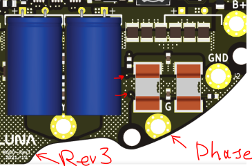

Please also note the shunts on the Ref6 of the Luna controller are placed on the low side while the earlier versions of the Luna controller (Rev3 for instance) have shunts places on the phases wires
OK guys, for the sake of the truth I lifted the shunts on the phase C circuit and yup, those two vias are Kelvin connections and yup, they just followed the straight most logical pattern and connected the current-sense amplifier straight and with wrong polarity (connected the low side to "IN+" and the high side to "IN-". Things about this controller are getting weirder.
